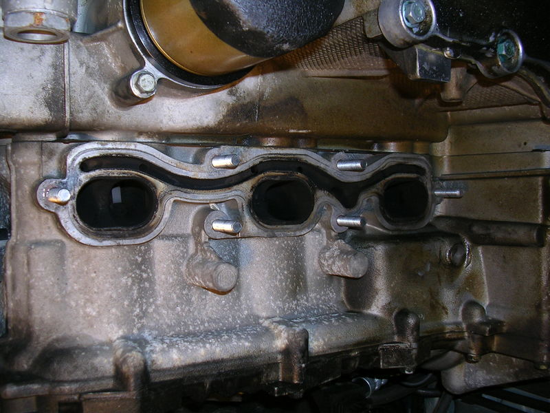

Originally Posted by edc View Post
Is there a reason you stuck with the standard manifolds? You can get a freer revving engine and a shade more power with some cheap but better flowing ones.
That’s a fair question.
I considered the use of aftermarket headers, but I selected the non-cat OEM manifolds out of my interest in keeping the system as laterally compact as possible, avoiding the “splaying out” of the header tubes beyond the valve covers.
The OEM non-cat manifolds might not flow as well as would a set of proper headers, noted. But for a street car I figure that they will serve me well enough, and they are most certainly a big forward improvement over the OEM cat versions which are a flow horrorshow.
Plus, you then know right from the start that the OEM parts will fit properly, without the need to monkey around with the often times imperfect configurations and alignment problems that one can many times see with aftermarket exhaust components. ( ... but having said that, the Circuit Werks resonator pipes, not shown in these new pictures below, turned out to be a perfect fit!)
Thanks - DM
If it helps my car is only road use and I've fitted the cheapy aftermarket manifolds to both my Boxsters with no issues and a slight improvement both times. I saw your pics and saw that you had already removed them. That is the one part that normally deters people. The labor cost to remove them is often more than the manifolds themselves.
I assume that the comment above refers to the often encountered difficulty in getting the 6 steel manifold bolts out of the aluminum cylinder heads without snapping them off?
If so, having the bolts out thus offers the perfect occasion to replace the lot of them with M8 x 42 mm long studs and matching SS flanged nuts
Years from now, whoever might have any need to remove these manifolds will thank you for your efforts to "stud" them today!
Cheers - DM

Originally Posted by BrokenLinkage View Post
Seems I recall the bolts at the triangular plate are splined at the base and pressed in, so inspect yours and if this applies, turn the nut not the bolt.
Pretty sure I replaced with normal non-splined bolts. Was a while back.
You are right about the splined bolts. They can be cut off with a Sawzall or hacksaw if you have lots of time. When I do muffler work I only take the saw under the car with me... I replaced with stainless steel bolts and nuts.
