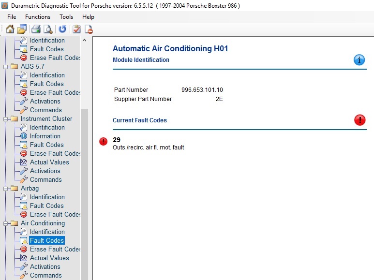

Got the Durametric out and had it run a test on my A/C system. It was telling me before there was an issue in the climate control unit, that's why I tried a different unit. Now it's giving me this error. Not exactly sure what I need to fix to fix this issue? Not sure if that would fix the A/C not blowing cold air either. The heater works fine.
