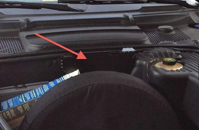

This is the location of where the original amp should be.
Also take in mind that most likely the after market amp was wired differently.
After market door speakers are usually full range. On the Boxster the speakers in the doors are woofers and the full range (two way speaker) is located in the dashboard.
Hope it helps.

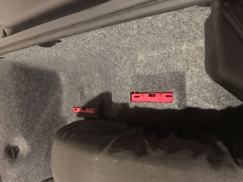

Yes this has helped and in fact answer a question. I have attached a photo I just took of something that has obviously been removed from behind the spare tire. I'm assuming that this was the power amp?
