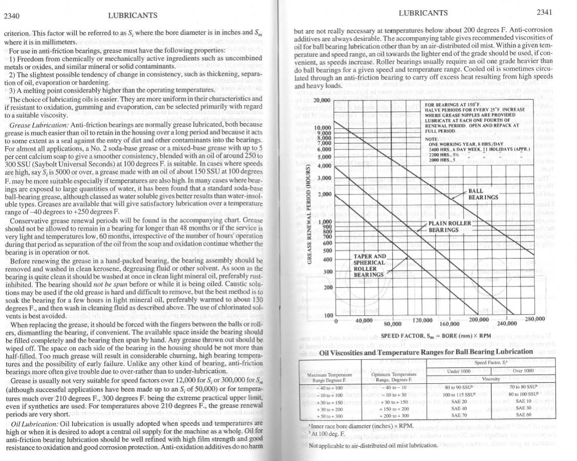

Originally Posted by Gelbster
Really ?
How will splash help a bearing that is sealed ?The cumulative wisdom of the IMSB world is the outer seal was the cause of much of he problem. Ditto the mainshaft and pinion bearing in the G86 that you allude to.
I ask because of the Hippocratic oath we should take when giving advice. "First,do no harm". If you have enough evidence to refute the cummulative wisdom of the experts, we're all ears & eyeballs.
I was stating"either or" no seal with splash or seal with grease. These bearings are called "anti-friction bearing" and yes the cumulative wisdom is just fear mongering and people are making money on this. The real issue is people not using their cars causing their bearing to pit from corrosion. Without pitting the bearing would not wear in the cars useful life.
Out of the machinery's Handbook or bible to most Machinist and Mechanical Engineers.
Picture of pitting, from google search.
Here is some reference, maybe I should charge for doing some research on the subject? Btw I have owned my "porsche" for 1 year now so new to this fear, but my hobbies and daily job allow me to analyse it a little further.
One question: how old is this book?

Originally Posted by JFP in PA
Which does nothing to explain why cars that are daily drivers, and driven hard, were some of the first to show the problem.
I don't believe that is correct. Everything I read on the subject its people who didn't drive the cars hard that had the problem occur to them.
The book is from 2004. So those who made the boxster had access to it:P.
Oh I love that plug idea. Cheapest solution out there. Only thing is to put a pin hole to allow pressures to balance preventing the plug to pop out if the situation allowing it arise.
https://documents.mrosupply.com/product_documents/10/100KSF/lubrication.pdf
A more recent document I found on the World Wide Web.
100+ years old, with many various Editions/Owners obviously, but essentially the same concepts bud. Fascinating literature
Edit: sorry, to be precise it is 125 years old ( https://www.amazon.com/Machinerys-Handbook-Collectors-First-Replica/dp/0831133708)
