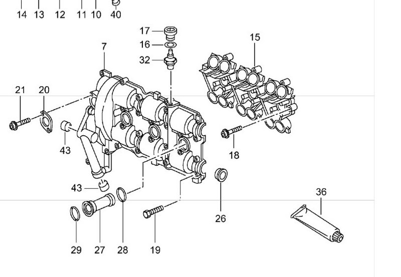

Hi thstone,
i think lifter means hydraulic lifter, right?
If the lifter carrier was worn, how was that repaired? As far as i know the lifter carriers are an integral part of the cylinder head. So did you overbore and use a kind of sleeve?
Or did you replace the complete cylinder head?
Thanks & regards
Markus
Old 08-08-2015, 05:07 AM   #26
Join Date: Dec 2009
Location: Orange County, CA
Posts: 2,036
As far as i know the lifter carriers are an integral part of the cylinder head. So did you overbore and use a kind of sleeve? Markus
Hello Markus,
I believe that the lifter carriers are bolted into the heads (between the heads and the cams), they look like cast aluminum egg crates

Hello Markus,
This. Lifter carrier bolts to the head.

Thanks flaps10 and Gilles,
found the carrier in the parts catalogue (number 15). So there is bolt on a hydraulic lifter carrier for each cylinder head. Now i understand how this works and can be repaired.
Thanks & regards
Markus
