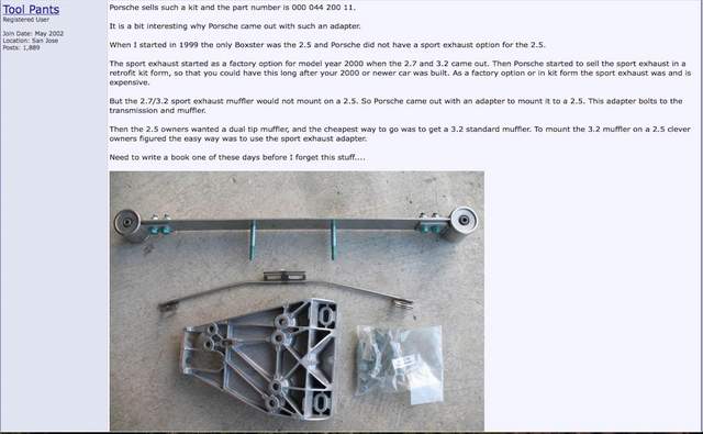

I've been doing some research but I'll need some help from experts now. I found a thread where Tool Pants refers to an adapter PN 000 044 200 11. In his response there appears to be a picture of the adapter which apparently is a kit. Any way to find what PN's are in this kit. The adapter appears to be the same as the ebay bracket in bottom photo. The two parts diagrams are for the -99 (lower pic) and the 00- (top pic) the 5 speed adapter #6 on the -99 and #8 on 00- diagrams are the same PN. Does this indicate the same bolt pattern on the 5 speed trans for all years? And if this is the case will the ebay mount PN 996 111 226 02 same PN as the 02 diagram, work on my 98 to hang the 03 S muffler on?

Here's a 2003 5 speed vs a 1997 5 speed
Some mufflers
I believe the piece in the middle is all you will need?

Yes Sir! Thanks for the reply with pictures! This should certainly help anyone else considering this mod. Please send me pm with your info on payment! I will update thread once I install. Thanks you are the Best!
