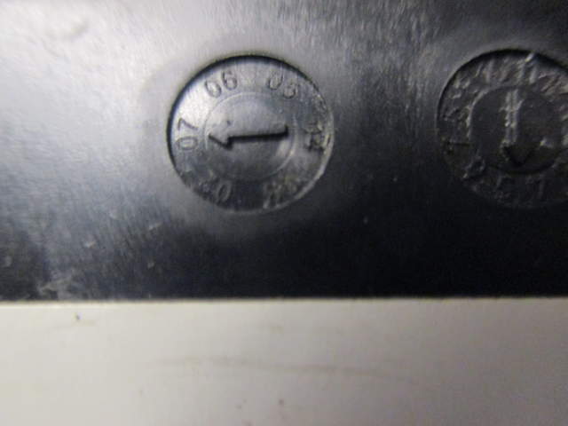

Date code on my Immobilizer is 2007 which considering the car is a 2001 likely means a recall/upgrade etc. Any Boxster Historians or other Wise Guy Comments?
BOOTLEG is offline   Reply With Quote
Old 12-27-2014, 12:42 PM   #2
Motorist & Coffee Drinker
78F350's Avatar
Posts: 3,963
I just checked two boxes from an '01 base and one from an '02 S. They all had an 01 date stamp and were part number: 996.618.262.01.
My guess is that your original module had water damage and was replaced with a new one from the factory. If the Immobilizer unit is replaced, the DME has to be re-programmed for it, or both replaced as a set along with the key.
