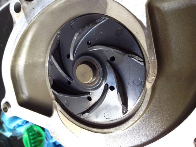

Sitting in the drive-thru and started to hear a fairly loud urethane / plastic type of noise...slight rev of the engine and the noise went away only to return. Not happy at this point...and I'm stuck in line with no way out...
Make the drive home (less than 2 miles) and don't see any abnormal indications. Sound seems to have stopped. Driving home, I see nothing on the road behind me as far as fluid leaks - and no unusual exhaust (smoke / vapor).
Pulled into the drive way and no sound?! So I pull into the garage and let it idle to see if I can hear the noise again. Nothing - but now the temp is creeping higher above the usual needle on the "0" of the 180deg marking. Temp fans come on and it keeps going up very slowly so I shut her down...
Hop out and then I see a small spot coolant on the driveway - similar to an air conditioner spot. Now in the garage, I can see (and hear) coolant leaking from the engine compartment just behind the passenger seat...
So - my guess is the impeller is toast - hopefully a ceramic impeller. I'm searching the previous owner's records for any replacements...any other thoughts if I'm headed down the wrong path?
A couple of searches about water pumps on the forum where helpful. Nice recent discussion on the types / brands as well as a good discussion on thermostats. The kit has a 160deg stat so that will get done at the same time. Water pump kit is now on the way from Pelican.
Might not make it by the "Labor Day" weekend...should give me time to tear out the old pump and have things prepped...

Well, new pump arrived today. Not too bad of a job. Having a flex 10mm socket is mandatory. Lol. Old pump bearing must have let go. You can see from the pic that the impeller isn't centered anymore, and several fins were chewed up as it wobbled / failed. My concern is having lots of small pieces in the system. Any thoughts on a power flush at this point? Pieces are not metallic so that's a small consolation...

Your biggest problem now is the plastic debris lodged in the cooling passageways of the cylinder heads. Some of the passages are small and if they get blocked or even partially obstructed by the remnants of your impeller, it causes localised overheating of the head. Not a good thing!!
Remove the thermostat and see if there is any debris in the housing and try and back flush the cooling system. I don't know how easy that is going to be, use the search function above to get more details. Perhaps JFPinPA, Jake Raby or someone who has already back flushed or cleaned out the cooling system can give you some tips.....
Well, went back thru some threads on the topic. Found this a few years back:
http://986forum.com/forums/general-discussions/42978-water-pump-impeller-tips-chips-your-cooling-system.html
Nice discussion on the process. Unfortunately, the gent that experience the failure was unsuccessful in finding any extra parts from his impeller despite the labor to back flush the engine. Perhaps they made it through and are lodged in the radiator - maybe they are stuck in the passages. Jake Raby added the commentary that he frequently finds parts of impellers in the passages during the rebuilding process in cracked heads...also the good advice to PM the water pump every 3 years regardless of mileage to prevent this type of failure.
Since I'm past the PM stage - I guess at this point I'm stuck as back flushing doesn't seem to produce good results. I will strain the fluid I collected to see if I can find any chunks. Earlier I think I found some pieces the size of ground pepper...but nothing substantial. After that, I think I might back flush the engine as a hopeful measure...that's about as far as I can go at this point. After that, I'm on borrowed time if the passages are truly clogged...I guess Jake will be in business down the road with me...tough to get my mind around pulling the engine early to find these pieces vs the consequences of not pulling the engine...I would defer to Jake / JFPinPA and the other seasoned wrench turners what they would do after a back flush in this situation...
