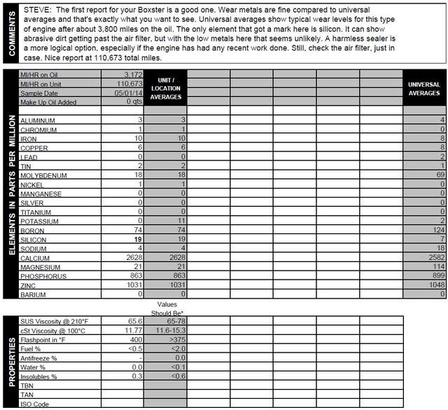

First oil analysis done by Blackstone labs, seems to be good.
Just got my first oil analysis report back from Blackstone today. Silicon was high, but it sounds like that may be traces of the sealant snakes that were in the oil sump pan, that I recently cleaned out. It will be interesting to see if it goes down at the next oil change now that I cleaned all that out. The rest of it seems good.
The oil I used was Castrol Edge 5W40.
Does anything on this report jump out at anybody on here?
Part of the usage on this oil was 7 HPDE session of about 20-25 minutes each at RRR and 8 autocross runs.
