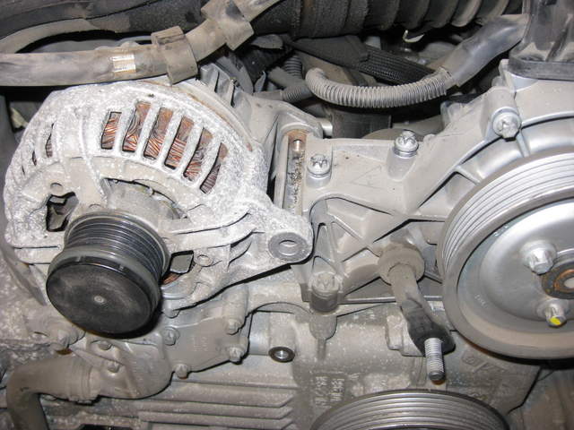

The battery load tested Good, so it's the alternator or voltage regulator. I'm trying to get the alternator out and am stuck.
Looking at Bentley and 101 Projects, both talk about "tapping" the idler pulley bolt such that the back bushing gets loose, allowing the alternator to be removed.
I've been doing a lot of tapping (some I'd have to call quite a bit harder than that) and wiggling. The alternator moves around a little, but won't come out.
The back bushing seems locked in the alternator flange and appears to require an awful lot of force to break loose from that flange. Look at the attached pic - that bushing is in there solid.
Is breaking loose of the bushing in the flange really required? What exactly is holding the alternator in on the idler pulley side? Is it squeezing of the support slot by the flange in the back and the pulley in the front? Now that things seem loose, can I just take a pry bar and lever up the idler pulley side (as one other forum member has done)?
To make more access, Bentley also talks about removing the U-shaped protective shield above the idler pulley. Of course it doesn't say how, and the bolt holding it down is impossible to get a wrench on without taking off the shifter cables. Anyone get it off?
Yes, giving the mounting bolt a solid smack is required as when tightened, it pulls forward and traps the mount. Once moved sufficiently by a couple of whacks, the alternator should pop right out.

I give up. I don't see any alternative now but to take off the intake to make some room to work (and to retrieve a lost bolt).
After shooting some PB Blaster on the bushing, I finally managed to knock it back about 1/8", and the alternator seems loose, but there's just no room between the idler pulley and the U-shaped shield above to rotate the idler pulley bolt up and out of its cradle.
I thought there was only one bolt holding on the shield (which Bentley blithely says to remove, without any instructions). I managed to finagle an offset socket through the cables and hoses onto it from the engine compartment, but once I had it out I managed to knock it back into some inaccessible crevice, even with my magnetic retriever. I then discovered that there's a 2nd bolt I can't seem to get a wrench on at all. Grrrr.

Don't give up yet. My alternator was also difficult to remove, in the end I found that removing the outside 10mm bolt holding the black intake manifold gave me an extra bit of space to rotate the alternator. The bolt is easily seen and only takes a minute to remove.
Also the bushing (once loose) should go back a little further than 1/8". Loosen the bolt out a bit more and give it another tap with a hammer after hitting it again with PB Blaster.
I didn't remove the shield either....

Clickman maybe this angle will shed some light.

OK, I admit it, I take instructions too literally, instead of applying a liberal dose of common sense.
I just backed out the idler pulley bolt the rest of the way and removed the pulley. The alternator then had oodles of room to come out. I had been following the Bentley and 101 Projects too closely, neither of which say to do this. And I read or saw on a video where one guy had tried backing out the pulley bolt and it wouldn't separate from the bushing.
Anyways, the alternator is out now, was tested, and the VR is being replaced. Interestingly, the decoupling pulley wasn't working either so it's also being replaced.
