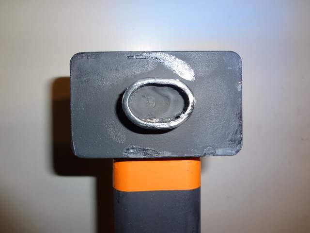

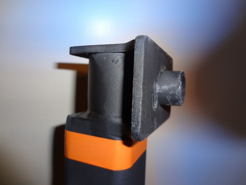

Another thing I will point-out is that the bars insert into the lift points of the Boxster, locking them into position, and the location where the jack stands are placed on the bars are rounded so the car can easily pivots while lifting the other side, eliminating the grinding of the car's frame on jack stands.

Great picts, Jager - thanks! This seems like an excellent solution. Does the kit come complete, or do you have to do any welding?

No welding, just two lift bars, and they are HEAVY DUTY!
