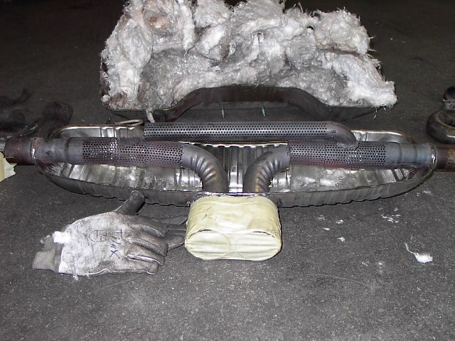

I'm surprised to hear that any aftermarket catback would have wadding. That's one of the major drawbacks to the oem exhaust. This what the oem muffler contains.

Yeah, I've heard that Fibreglass packing doesn't last, SS packing holds up better. Even then, some types hold up better than others, with SS "scrubble" holding up better than various grade of SS wool.
