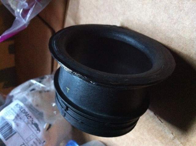

For those with the stock air box behold the jaykay short snork:

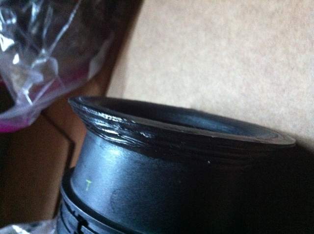

It will help reduce some the intake flow losses if you are de-snorked. The sharp edge on the air box can really reduce flow efficiency!
I am still shaping it and need a wierd router shape to finish it!

Here it is further shaped! I will test it this spring..

Thanks.......... a lot plastic weld and Dremel shaping.
This is much better than the air slamming into the side of the airbox!

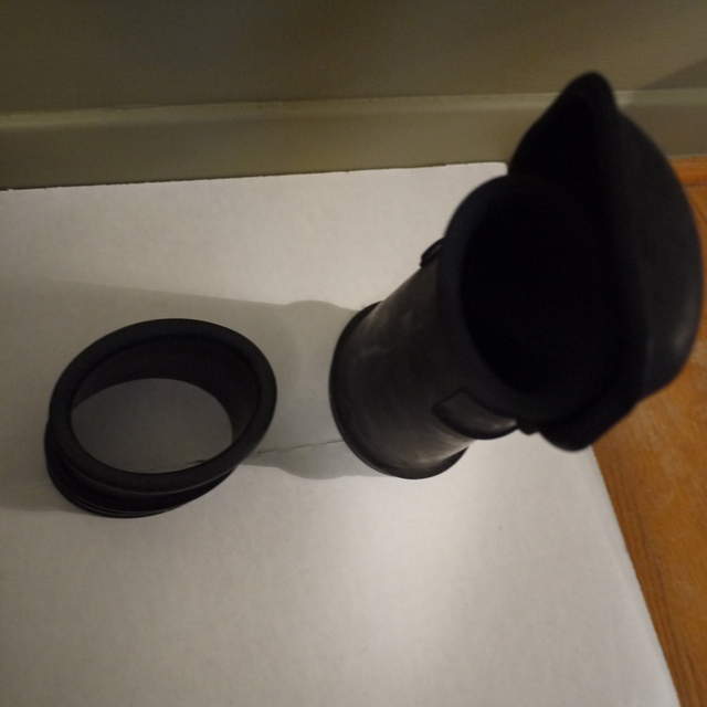

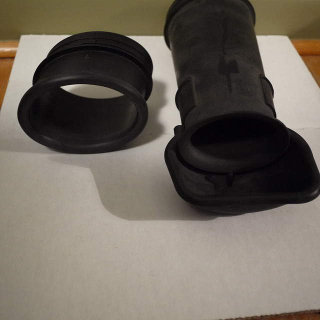

Sooo when you de-snorkel for that wonderful intake sound you get this:
The air is running into the air box wall and then having to flow over a sharp edge. I just could not stand it! So I took the snorkel and massaged it a little. Notice the difference in flow areas before and after:
The short snorkel installed looks like this:
Buttoned up and ready for a night test:
So far so good! The nice intake sound is maintained and perhaps a little nicer, while getting rid of the sharp edged entrance to the air box. Throttle response seems a tad crisper but of course this is biased placebo effect comment. There seems to be less of retort/stumble from the air box when I stab the throttle at idle
