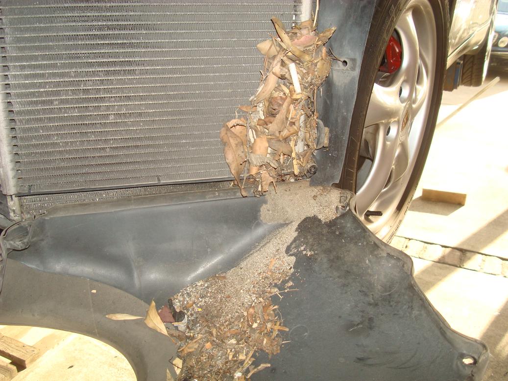

doubt the relay is bad but you can check that. Removing the bumper is not hard and you should do it every once in a while to clean out the junk stuck in the radiators. be sure to move the condenser out of the way to clean behind it as well.
Yep, there is a ton of sand in there.
