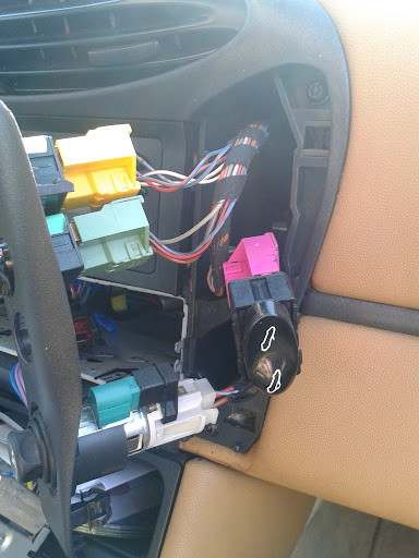

A while back my top worked intermittently. I was thinking about just waiting till I could get it down, then try to get the speedster kit. After getting angry and pushing it really hard it worked! So I just had to press harder (but sometimes not all the time). Well today it was being stubborn and I pushed it (really) too hard. Now my button is in the dash :-( And now I have to take off the dash and figure out what I broke and how to fix it.

Thank You Meir! Now I just need your prayers for patience while I attempt to take apart the dash without snapping, smashing, and breaking everything. Wish there was a youtube for it. Hope to find out soon if I don't scrap the top altogether.

Just an update, I was able to get apart of the dash off (just the part i needed off!) I don't know if me taking out the stereo had anything to do with it, but I just pulled from the lower right corner and it came right out!
Now I have to find and check the fuse for this button. Then check the other 2 switches :-/ I might just try to get the entire top down first and just get a speedster humps.
