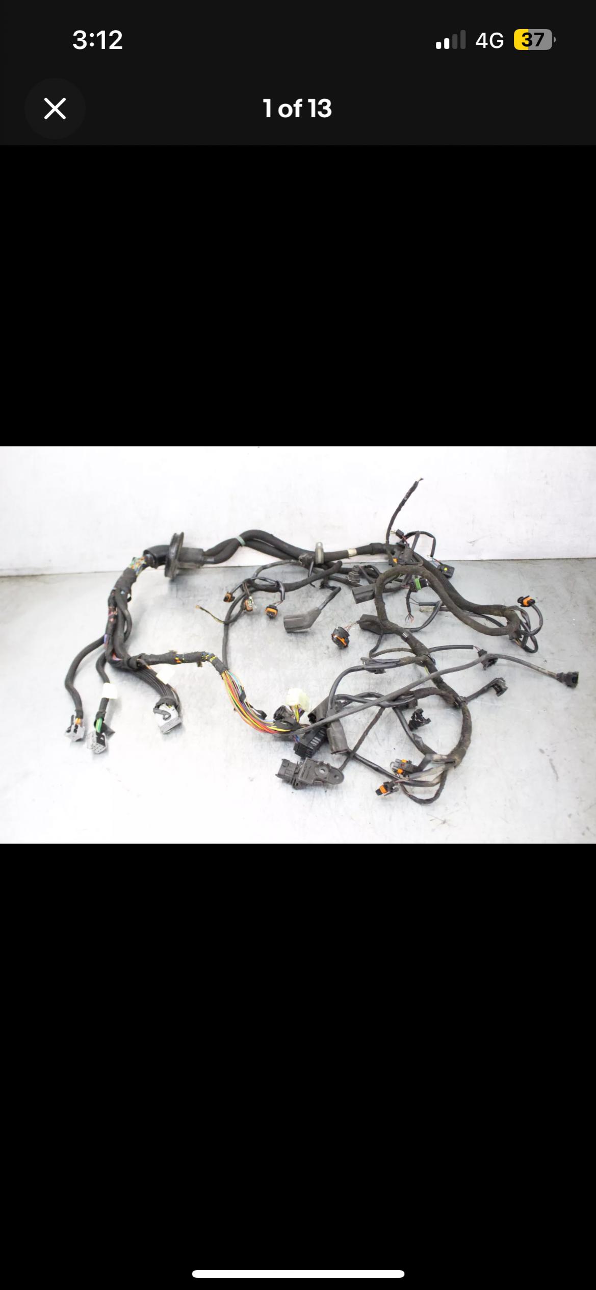

Hi again, I am looking a getting a 3.2 engine wiring harness but I seem to be finding two different ones there is one with a long plug on the end see photo with blue circle and one that doesn’t have it. How do I know what one I need?
Cdeboer is offline   Reply With Quote

The difference is that the one with the blue circle is for a Tiptronic transmission and the other is for a manual transmission. The circled connector plugs into the transmission control module - not used in a car with a manual transmission.

So good news it started!!! I ended up getting a 2.7L wiring harness for it that was pretty much just plug and play. I do have a few issues with it tho, I have a few codes come up and it idles a bit rough due to a cam sensor problem.
