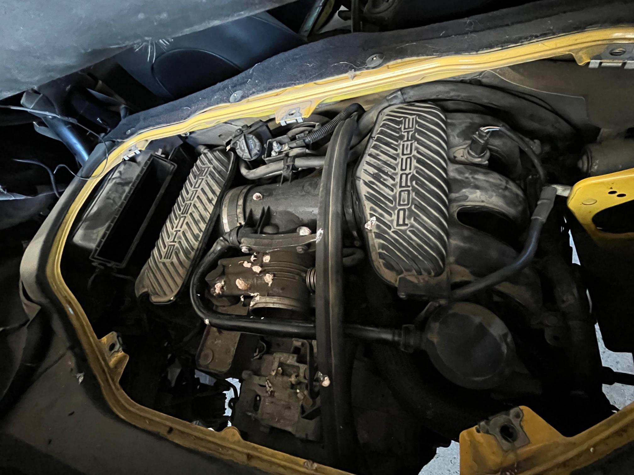

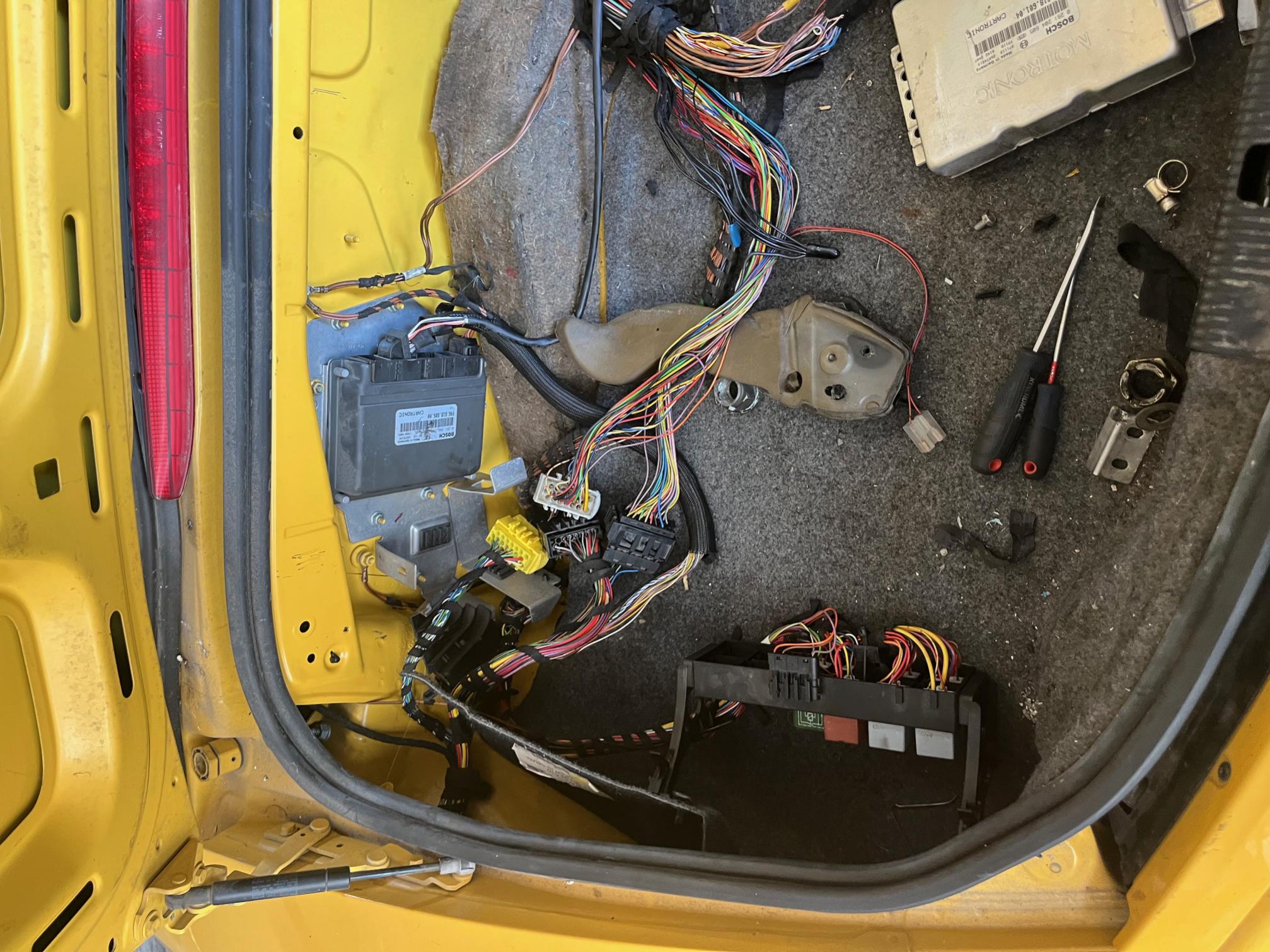

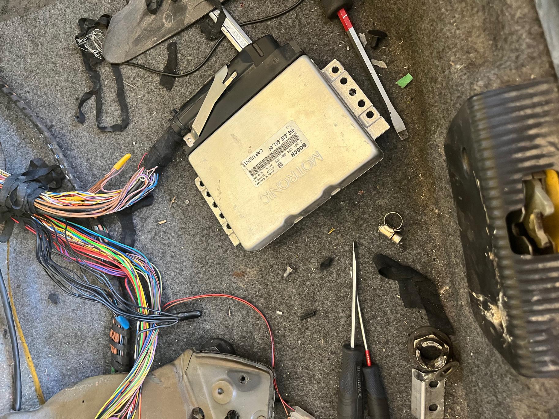

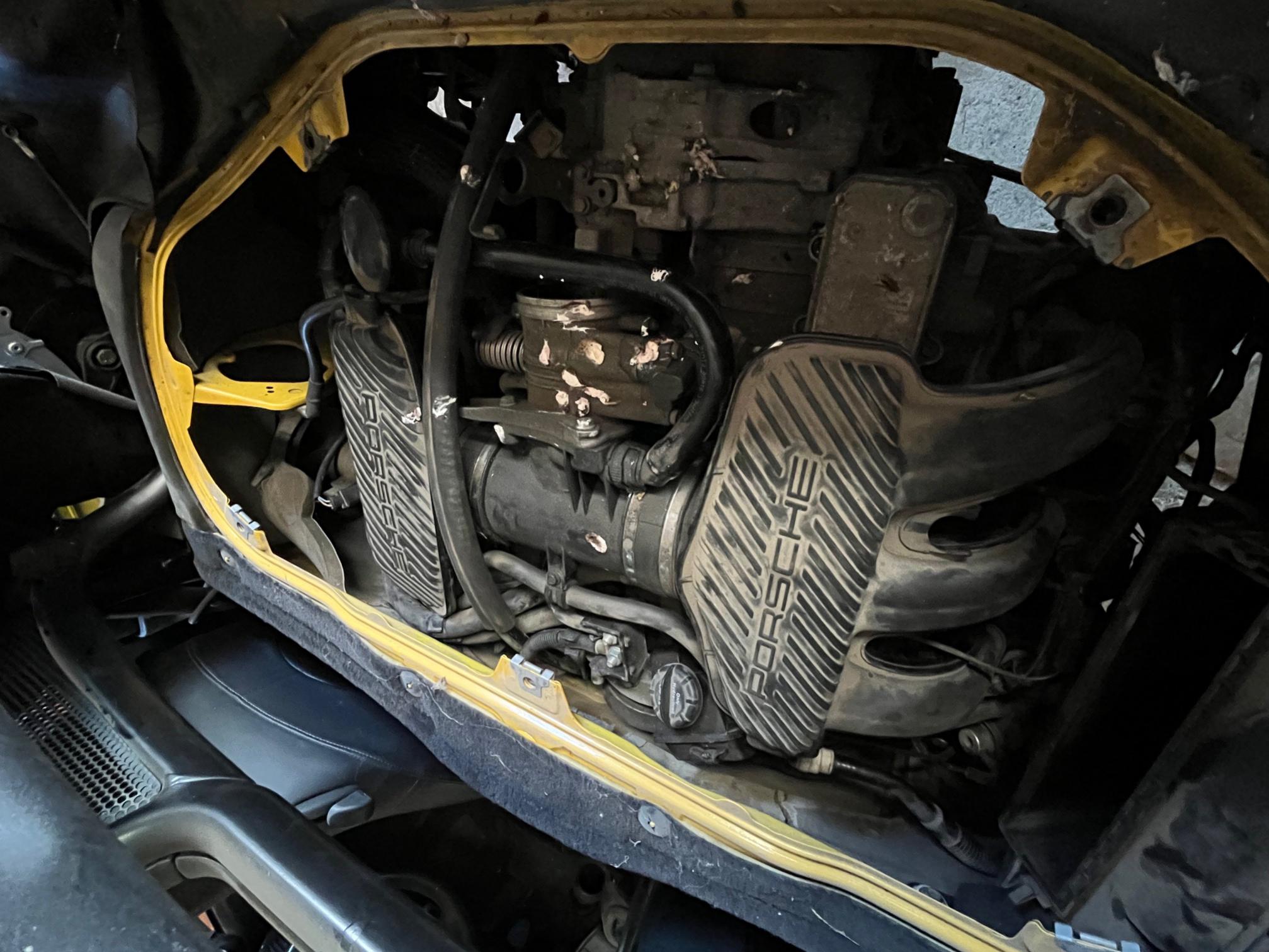

Cdeboer 02-19-2025 10:33 PM
5 Attachment(s)
This is what the top of the engine looks like and the ecu

What I see in the pictures is that you have the ECU from the 1998 and the ECU from the 2000 S. If the wiring harness has not already been modified, it would probably be best to get an engine harness from a 2000 - 2002 engine along with a throttle body. *The tube from the Air Oil Separator will also need to be modified to connect to the '00-'02 throttle body. With that, the 1998 engine can run in the 2000 chassis with minimal modification.
1997 - 1999 Boxsters have a mechanical throttle cable to control the engine. Your car does not have a throttle cable visible in the pics. The 2000 model does not have a throttle cable to control the throttle body because the 2000 and later models use an electronic throttle.
I don't see a tube going from the air filter housing to the throttle body. The missing tube should have the Mass Airflow Sensor.
It's going to take some 'hacking' skill to get this to work, but it can be done.

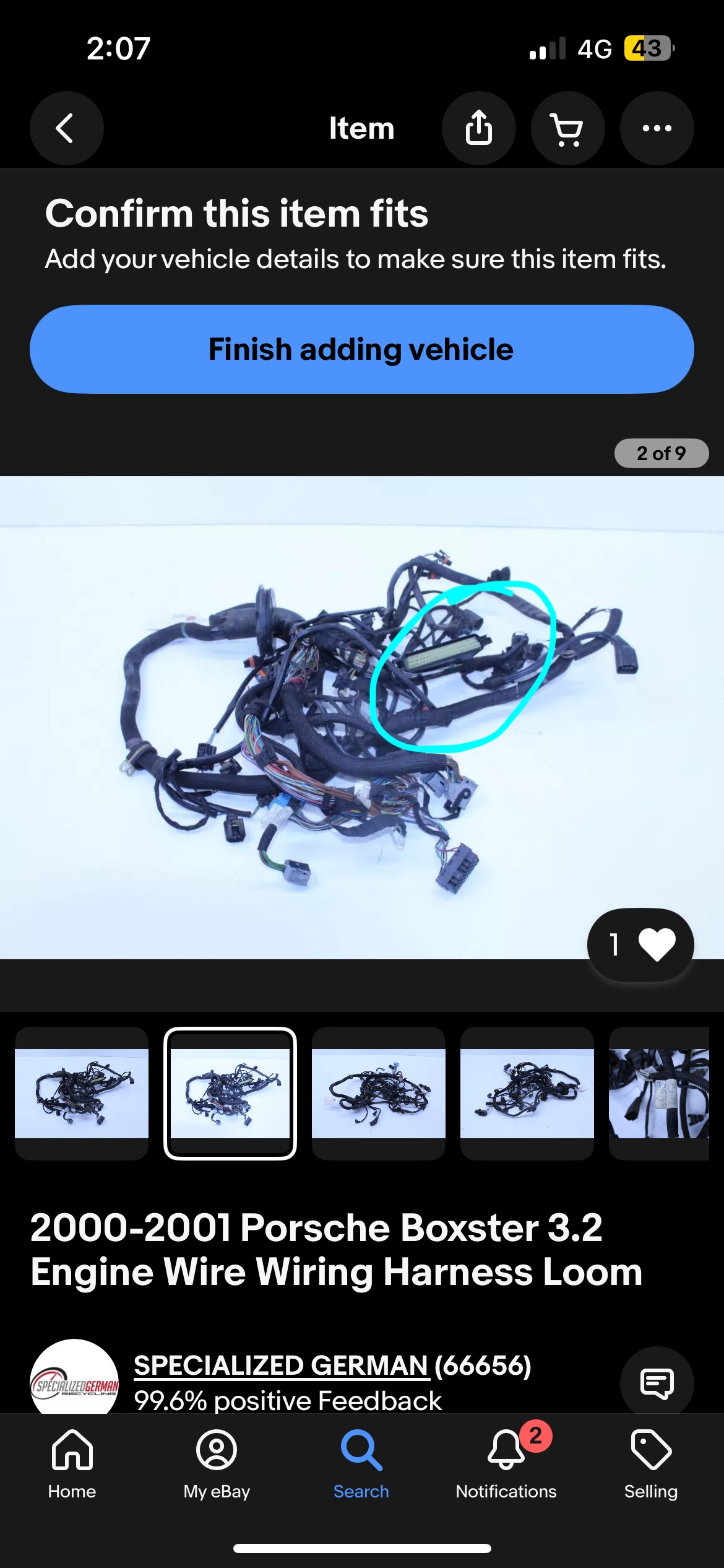

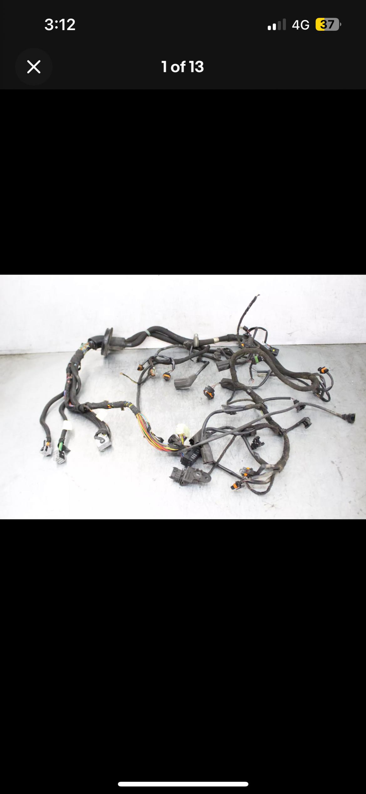

Hi again, I am looking a getting a 3.2 engine wiring harness but I seem to be finding two different ones there is one with a long plug on the end see photo with blue circle and one that doesn’t have it. How do I know what one I need?
Cdeboer 03-24-2025 09:32 PM
2 Attachment(s)
Attachment 23747
Attachment 23748
78F350 03-26-2025 05:46 AM
The difference is that the one with the blue circle is for a Tiptronic transmission and the other is for a manual transmission. The circled connector plugs into the transmission control module - not used in a car with a manual transmission.
