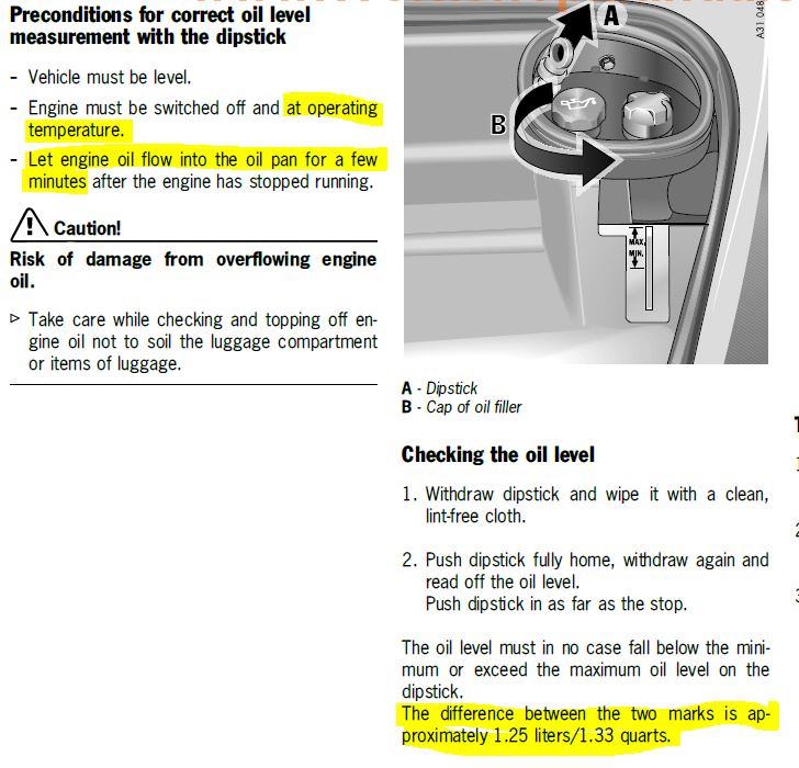

3 days is a bit long to wait, but you are correct, it does take a long time for all the oil to drain back down
Slightly high when hot probability won't cause anything bad
Per the manual, you should check the oil hot and after a few minutes of shutting down the engine. ( yes it does say "few" minutes)
As oil does expand when hot, cold readings will be lower
