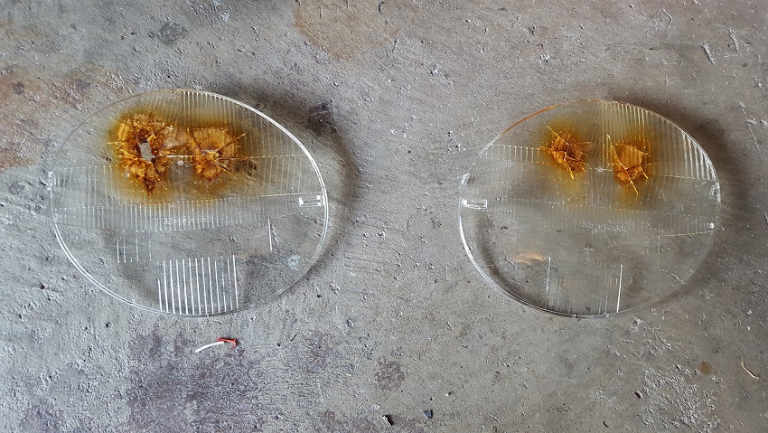

Another problem that I have to figure out how to deal with is baked lens debris sticking to the inside of the outer lens. I'm not sure how to get this stuff out without scratching it.
particlewave 08-31-2015 03:56 PM
Wash your hands with hot water for a good 2 minutes to soften the skin. Scrub your fingertips with a scrubber to remove any dead skin.
Lay the lens over the sink (inside up) and fill with warm water and a good 2 tablespoons of dawn dish soap. Add the soap after the water so that it doesn't cause a lot of bubbles. Use your fingertips to lightly wash the inside of the lens and rinse with warm water. Use compressed air to blow all water out. ;)
This is the method I use with every set that I do and it never causes scratches.

amagalla 09-09-2015 12:14 PM
2 Attachment(s)

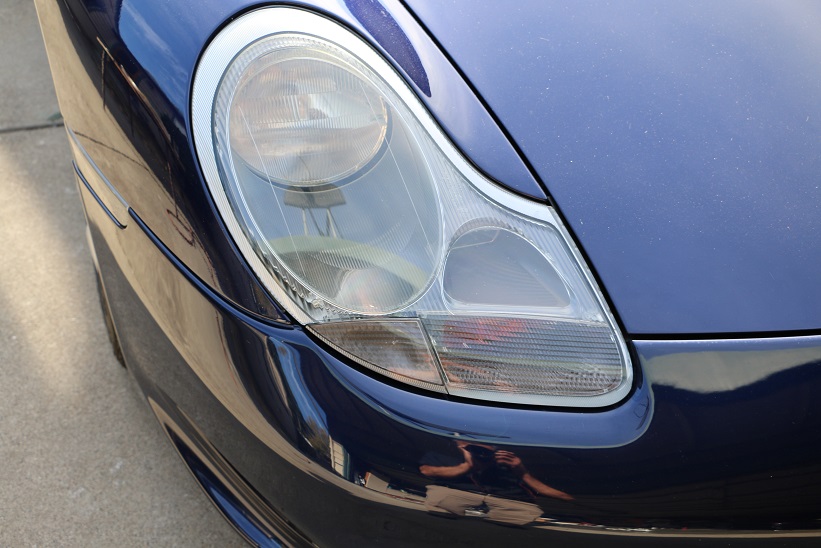

These are the lenses that I started with.
Attachment 19685
There is actually a hole burned into the passenger lens.
This is where they are now:
Attachment 19686
The last steps are to clean the inside of the second drive side lens (passenger side done already) , seal the lenses, and polish the out side.

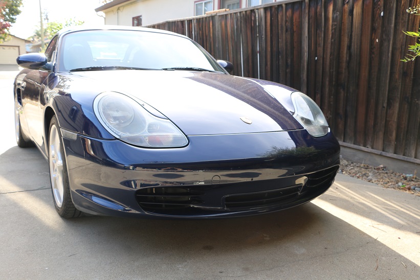

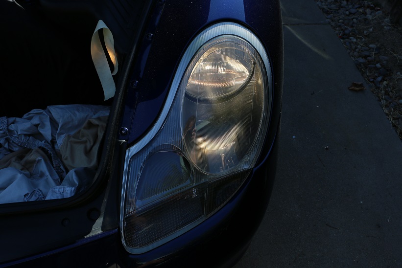

I finally got all of the pieces in place to finish the headlight upgrade (was waiting for the corner pieces and the LED bright and fog lights). Here is what they looked like before:
Attachment 19733
Attachment 19734
Both headlights are in really good shape. But this looks so much better:
New
Attachment 19735
vs. Old
Attachment 19736

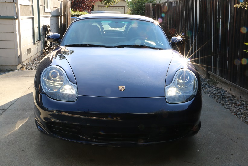

There is a notable difference in the headlight housing itself. If you look closely, you can see that there is a sort of diamond pattern on the inner shroud of the new headlight in front of and just below the projector. I mention this because if I had not bought these as a set, it's possible that you could end up with two different housings.
Here is a head on view:
Attachment 19737
Man, these look so cool.
Tony

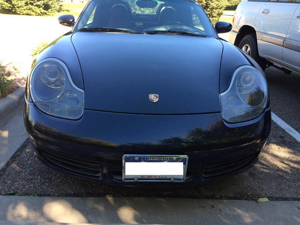

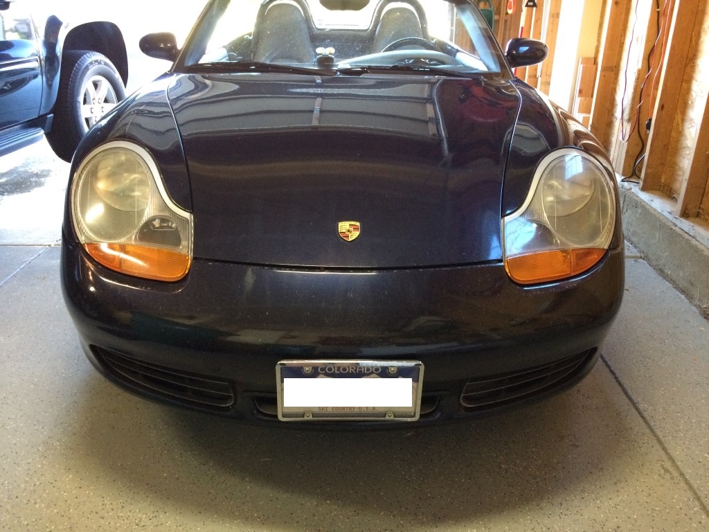

Here is my before and after pics. I picked up a set of Gen 1 lights from another member and installed them in minutes! Gotta love plug and play!
Before
Attachment 19817
After
Attachment 19818
