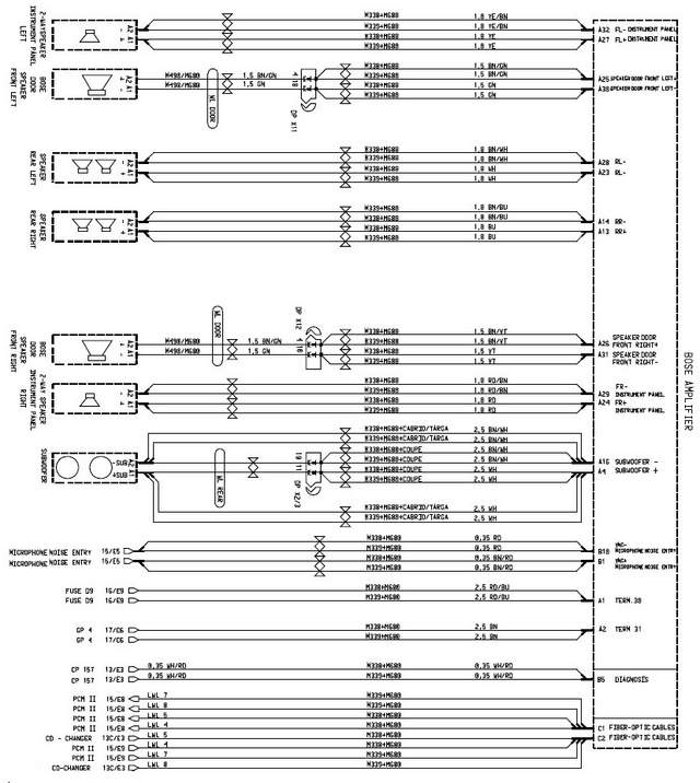

Anyway when looking at the pinout of the existing amp it looks like the rear deck enclosure is driven as 3 separate channels from the amp (rear L/R, sub) but other posts suggest it is really 2 channels with the "woofer" and midrange drivers in parallel for a 2 ohm load per channel. Does anyone know the real truth about this?
If there are only 2 channels of speaker wiring to the rear, my original plan of using head unit power for the rear midranges and bridged amp power for the subs (re wired in series for a 4 ohm load) is no good unless I pull new wires, which I'd like to avoid having to do.
