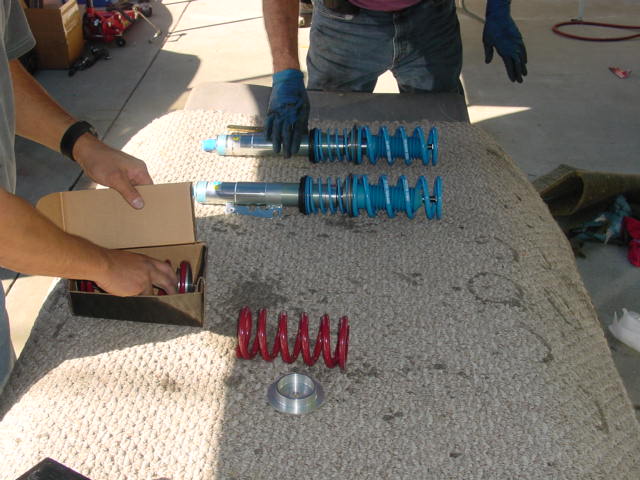

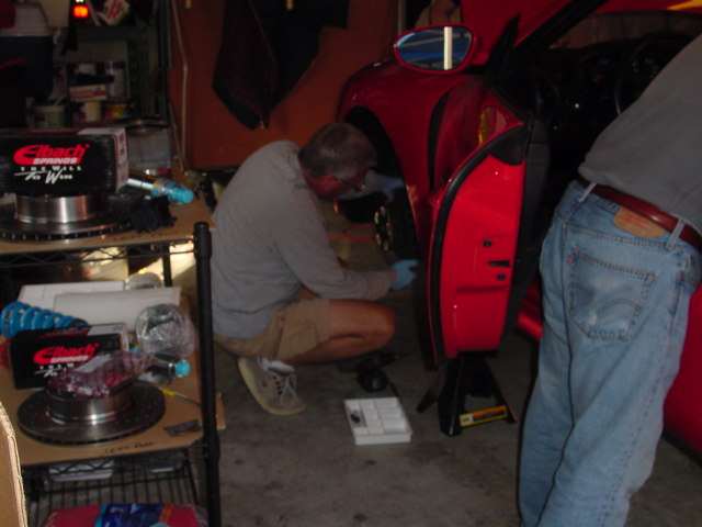

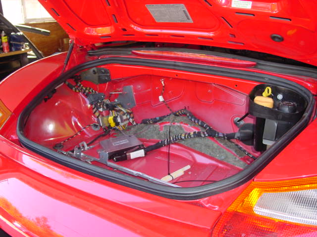

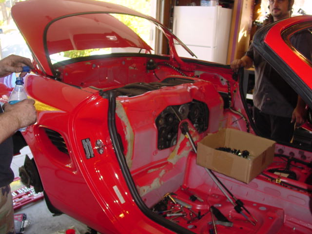

Sat/Sun Oct 21st and 22nd: R&R Spec suspension and gut car

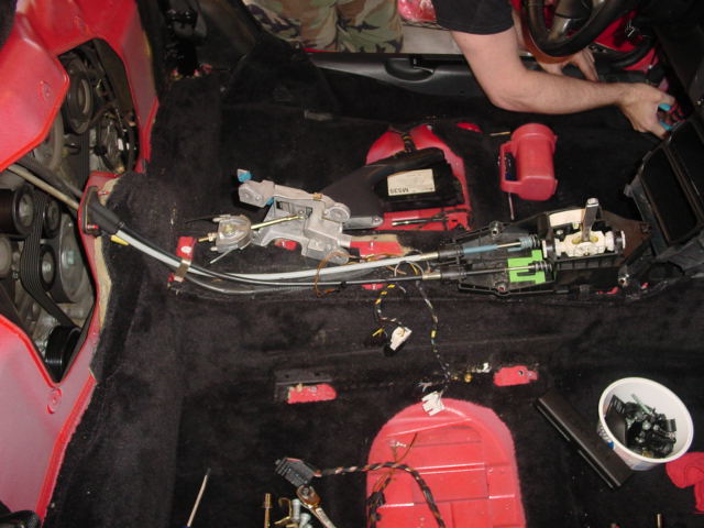

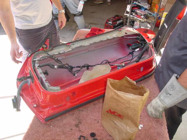

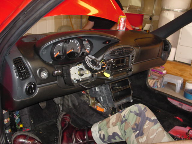

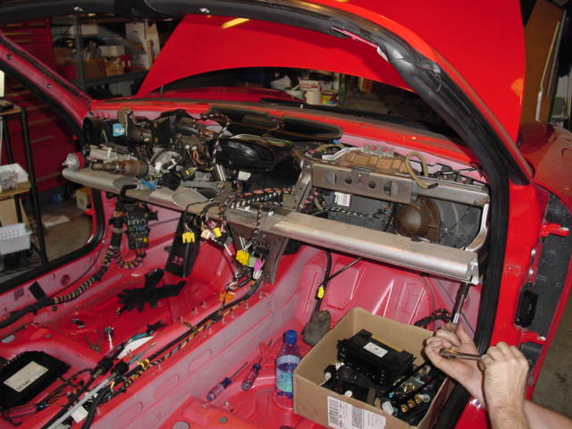

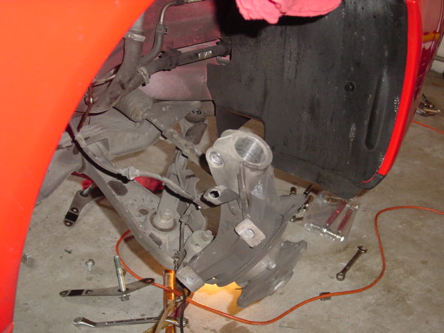

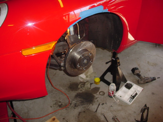

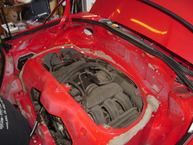

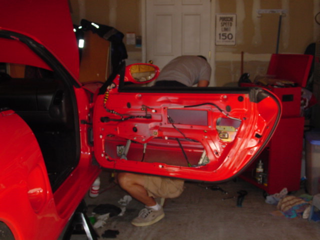

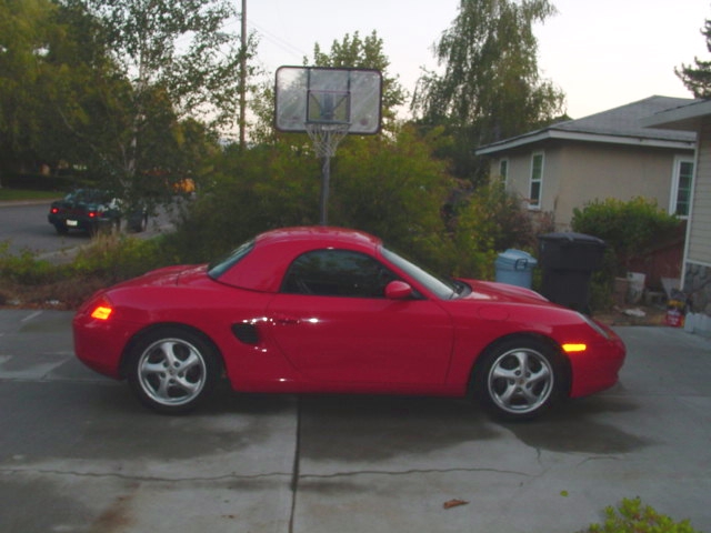

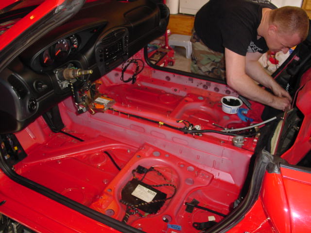

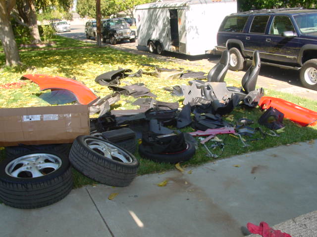

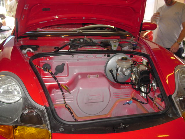

Here are some pics documenting what we did.
We started with the donor car, 1997 chassis with 68K original miles and hardtop.
