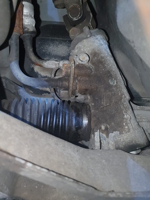

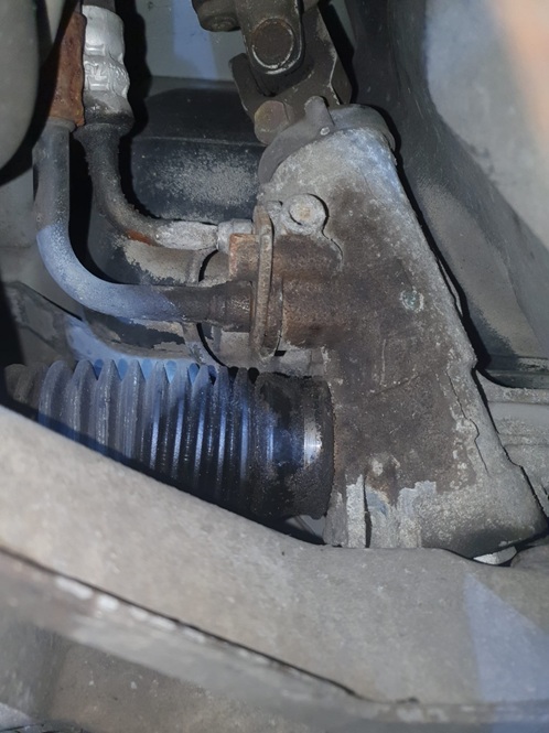

Today I 'inspected' the steering rack. I was mainly searching for the part number to ensure I order the right boots. Didn't succeed in that, got the 996 and a bit, but not the last numbers that actually matter.
Anyway, I noticed the driver side being dirty;
Having read that the main failure of the racks can be found by a boot full of power steering fluid, this did scare me a bit. I popped the boot off but found nothing but a greasy rack
I was now able to rock the tie-rods in different directions on both side. Passenger side, no play found, no noises, all good. On the drivers side I could get the clunk by rocking the tie-rod up and done (fore-aft was silent). It didn't sound like it was coming from the tie-rod itself. With the boot shifted aside I could see the rack (to toothed part) move along with the clunk.
So I guess I am looking at getting a replacement rack....

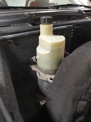

Meanwhile I ordered and received a Volvo power steering pump. Cheap and low mileage unit, so should be good. I'll probably give it a short test in the weekend to see whether it spins up.
So far, I don't think it is going to fit where I wanted it to:
Alternatively I could fit it behind the front bumper. I have all the hardware to install the third radiator there, but am questioning the effectiveness anyway...
I'll need to have a further look into this.
Attachment 23808
Mark, if you didn't find any oil inside the rubber boots, then the leak is from the viton o-rings that connect the metal pipes to the rack, these are not expensive and very easy to replace.

Thanks Gilles. I'll make sure I have new one in there when I swap the rack for a rebuilt one.
My point is that you may Not have to swap the steering rack and only have to replace the o-rings to stop the leak, awesome project, none the less :-)

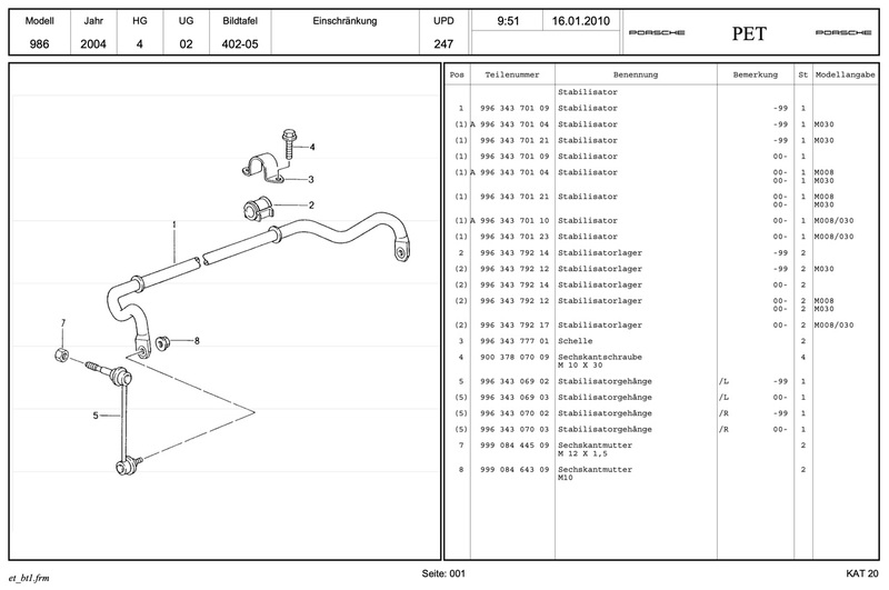

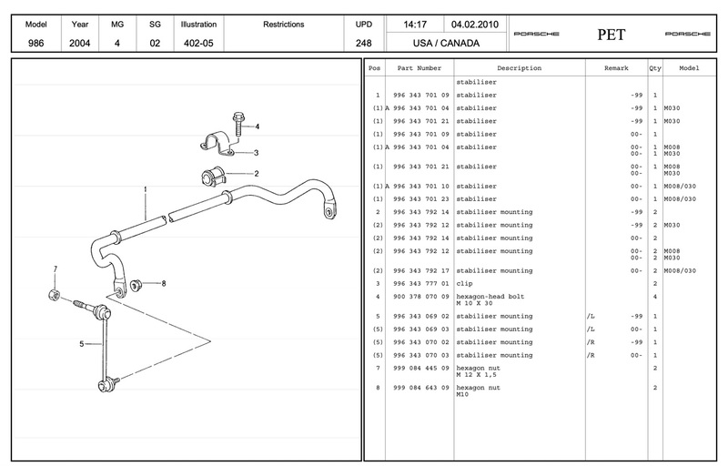

Part number of US and ROW sway bars are the same. So i suspect parts are identical.
Please take into consideration that stabilizer mountings and linkages need to be matched to the sway bar you choose.

Ah yes, but I'll replace it because of the play I found, not because of the minor leak. I am quite positive this is giving me the strange feel when turning. Even my wife notices it, so it is an obvious behavior.
Thanks, that's really helpful. I'll take the front ARB of the wreck and see which size it is. For now I can only measure in the bend and that's not very accurate at all.

With all the stuff out of the way it is also time to think about the position for the power steering pump. Basically there are two options, each with pros and cons. I would welcome some feedback and / or alternative ideas.
1. Mount it in the frunk:
+ easily accessible
+ close to wiring options
+ 3rd radiator option remains open
- takes space away from the frunk. Might not be the most visually appealing.
- might mean I can't mount the spare wheel anymore
2. Mount it at the front, behind the bumper cover
+ seems like plenty space there
+ easy hose routing to the rack
- longer electrical wiring, but still ok I guess
- not accessible to fill it up (although I can't recall the last time I had to top up power steering fluid..)
- no more option to add third radiator
On the aesthetics of option 1 I was thinking of getting myself a brake reservoir cover from a RHD vehicle. That might work out nicely.
