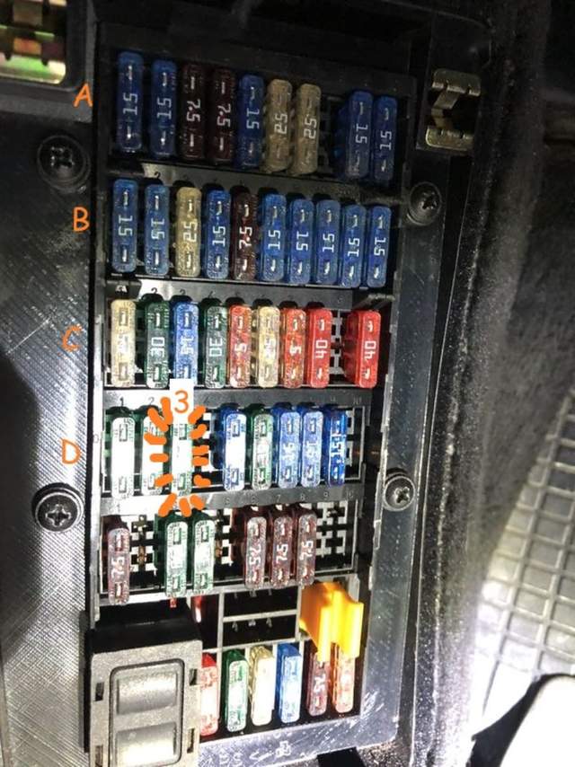

Yes, I figured that out, but thank you. Could you point out D3 on the panel itself? That's what I'm scratching my head about.

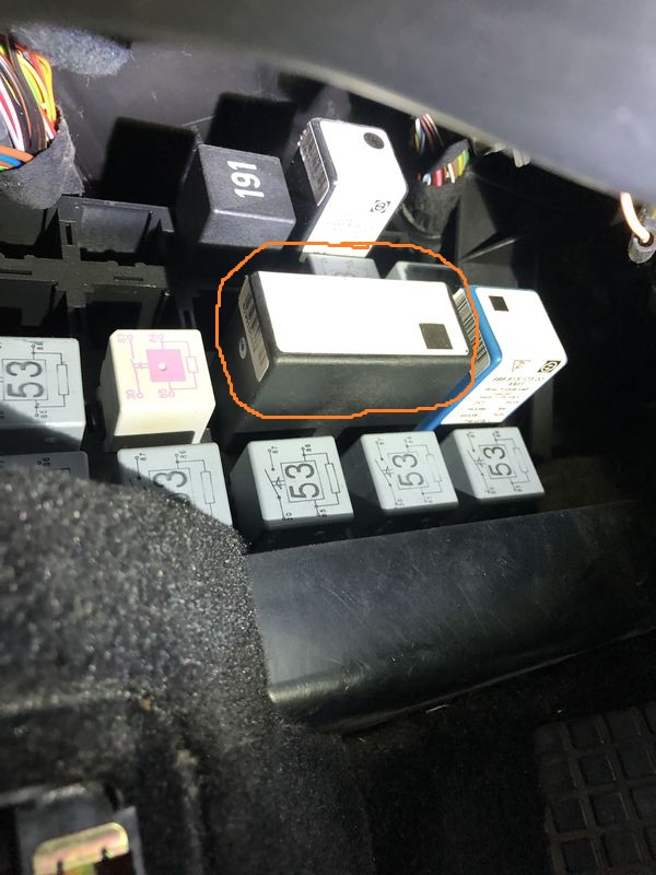

Much obliged, 78F350! That's exactly what I needed. I'll check that fuse, but it could easily be the relay instead. Relays get corroded. Tapping it on a hard surface like a pack of cigarettes often fixes the problem.

This may sound stupid, but did you release the latch? I have another convertible with automatic latches, and when try to open the Boxster, I often forget to open the latch. It's a brief "WTF??" moment until I remember I have to unlatch it.
And btw, that sixth row by the spoiler switch is for spare fuses.

Fortunately, I had the presence of mind to release the latch above before I pressed the button. And I removed one of fuses from the sixth row, realized there were no contacts for it in the panel, and concluded they were spares. As for the missing fuses in the panel, mostly in row E, I assume those are for options my car is not equipped with. (BTW, I need to need to make sure all fuses are facing the same way, to keep my OCD at bay.) Thanks for chiming in, Al. That was actually an astute question. Sometimes the most obvious things are easy to overlook.

The 30 amp fuse at D3 looks fine. I removed the relay and tapped it on a hard surface to free up corroded internal contacts. Still no go. The total silence when the button is pressed is odd. I would think I'd hear a click, buzz, hum, or something. That's why I suspected a fuse or relay. The relay could still be bad, but I'm not sure how to check it with my multimeter.

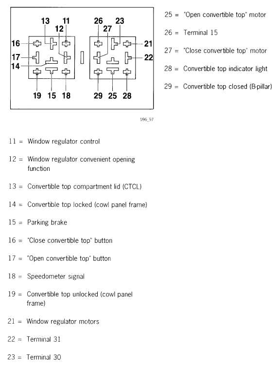

Any chance that the motor for the top was disconnected while you were around the engine compartment?
Here's the Pelican Parts DIY for top repair which may or may not be helpful: https://www.pelicanparts.com/techarticles/Boxster_Tech/71-BODY-Convertible_Top_Repair/71-BODY-Convertible_Top_Repair.htm
Somewhere I've got a troubleshooting chart for the relay. It may be hidden in the Bentley Manual somewhere too. Here's a post from 997_986 that looks like it has the same procedure: https://986forum.com/forums/662149-post7.html

If you have a multimeter (or even a test light), I found this that 997_986 also posted:
I recommend checking these points before you test it with a new relay...
TROUBLESHOOTING ON THE RELAY CONTROLLER
Note: Control relay disconnected. The terminal designation on the relay (Fig. 596_97) is from the underside of the control relay.
1. connect the measuring device (voltmeter) to terminal 22 (earth) and terminal 23 (plus 30) on the relay plate. Display = battery voltage
2. connect the measuring device to terminal 22 (earth) and terminal 26. Switch on the ignition. Display = battery voltage
3. connect the measuring device to terminal 23 (plus) and terminal 15 (handbrake applied). Display = battery voltage
4. connect the measuring device to terminal 23 and terminal 16 (close soft top button). Press close button. Display = battery voltage
5. connect the measuring device to terminals 23 and 17 (open soft top button). Press the open button. Display = battery voltage
6. convertible top locked . Connect measuring device to terminal 23 and terminal 14 (microswitch wind frame). Display = battery voltage
7. convertible top locked . Connect the measuring device to terminals 23 and 29 (microswitch B-pillar). Display = battery voltage
8. top unlocked. Connect the measuring device to terminals 23 and 13 (microswitch closed, soft top compartment lid VDKD open). Display = battery voltage
9. convertible top unlocked . Connect the measuring device to terminal 23 and terminal 19 (microswitch wind frame). Display = battery voltage
Connect control relay to relay carrier. Open the soft top compartment lid and disconnect the electrical plug connection on the drive motor-top drive.
10. connect the positive of measuring device to terminal 1 (black cable) and the negative of measuring device to terminal 4 (green cable). Kl. 2 and Kl.
11. connect the positive of measuring device to terminal 4 (green cable) and the negative of measuring device to terminal 1 (black cable). Bridge terminals 2 and 3 with an auxiliary cable. Switch on the ignition and press the "Close" button. Display = battery voltage
Btw, afaik from 2000 onwards there are only two microswitches, one in the lock and the other in the planetary gearbox. No microswitch on the bracket of the motor.
The above, along with the diagram 78f350 gave you, will help you determine the health of the circuits and hopefully rule out either a mouse chewed out some wires or a bad relay.
For example, if you get no voltage when you test the handbrake circuit (test #3), but you have a handbrake light on the dash then you know the switch is fine, but there's a break in the wire before the relay.
I have to admit, test #10 has me puzzled as I don't know what they mean by "KI. 2 and KI."
But the other tests seem straightforward.
