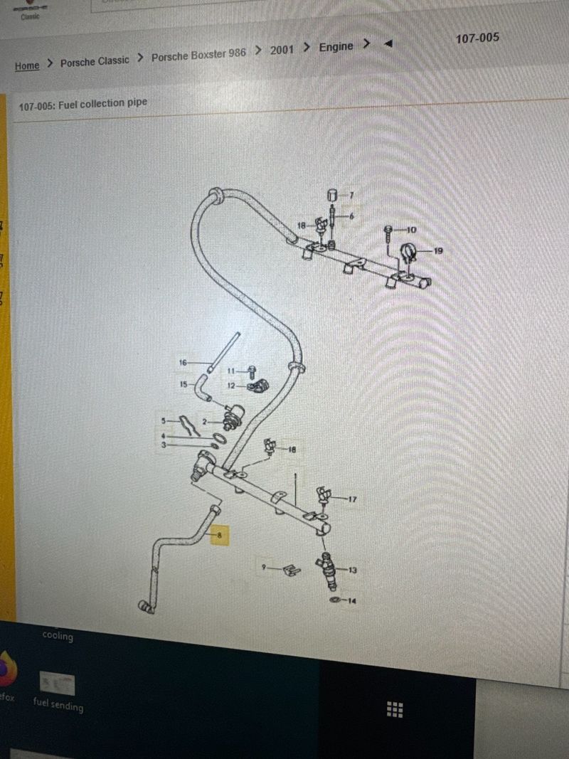

Talked to Pelican. They said Porsche calls it simply a "fuel hose," and Pelican would need to order it from Porsche. It's #8 in the exploded view below:
The discounted price for a Genuine Porsche replacement through Pelican: $280.
Seems a little high...

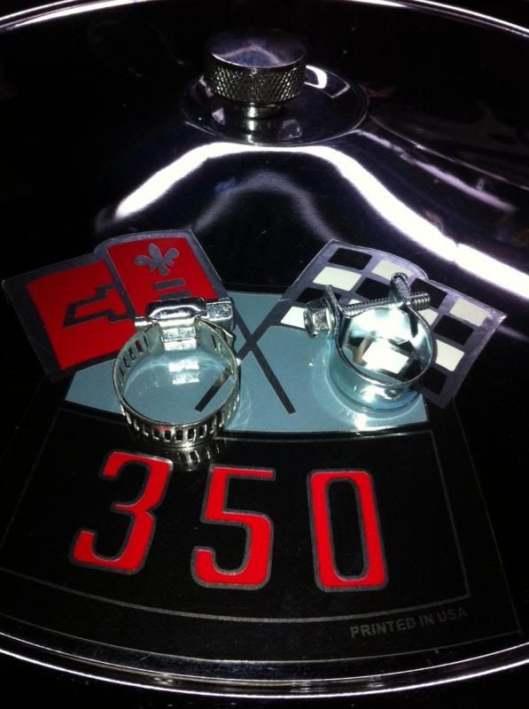

You need to remember a couple of things when working on fuel injector flex lines:
1. These hoses are not common hydraulic hose, they are designed to withstand considerable pressure and not be degraged by ethanol containing fuels, which swell and destroy common fuel hose.
2. Clamps used on injector flex lines are not simple worm drive hose clamps, they are stainless steel fuel injector clamps:
JFP, di you know how much pressure would the return line be handling?
Old 04-04-2025, 02:39 PM   #445
Posts: 6,653
It varies according to the amount of fuel being returned, but it could be as high as the full injector pressures, which is around 55 PSIG.

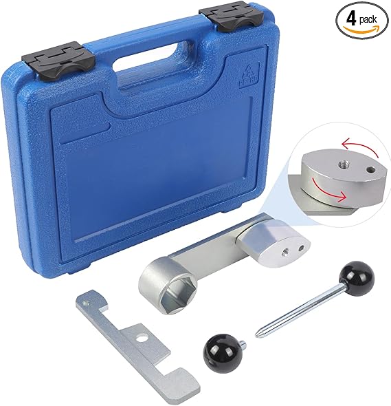

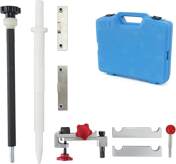

I think I've finally beaten my cold. It robbed me of two weeks I could have been working on the engine. However, I spent the time productively, studying how to replace the cam chain wear pads. Turns out the camshaft alignment/timing toolkit I borrowed from a generous forum member is the wrong kit for my 5-chain M96. The borrowed kit contains these tools:
Here's the kit I need:
Which means I'd better cough up $97.87 for the correct kit if I hope to get the car on the road before winter. I'm also ordering a few more parts for the procedure:

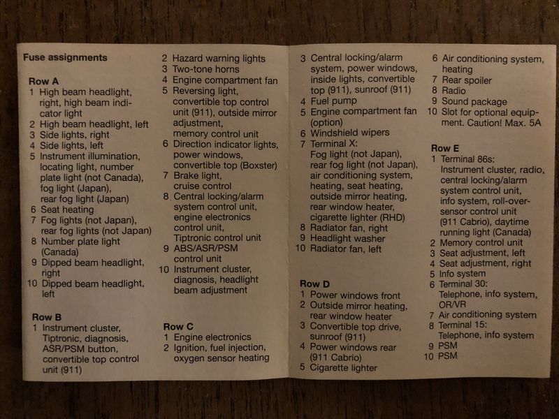

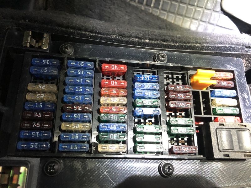

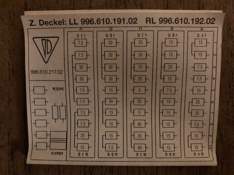

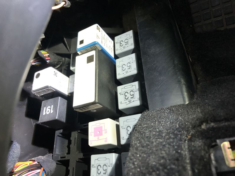

While waiting for the cam timing kit to arrive I figured I'd begin the process of dropping the old engine. After elevating the car on jack stands, I tried to put it in service mode, first making sure the parking brake was engaged and the relatively new battery was charged to the max. But nothing happened when I pressed the button. Nary even a click, buzz, or hum to be heard. The powered top was working properly back in September when I parked the car, but it ain't working now. "Fuse," I said to myself, "or relay." I removed the fuse panel cover to have a look. The little booklet thoughtfully provided under the cover indicated that B6 and D3 are the fuses for the convertible top:
However, B6 also powers the turn signals and windows, both of which are functional, so if a fuse is the culprit it would have to be D3. The fuse panel layout:
I couldn't help but note that the layout in the booklet doesn't seem to correspond to the panel's layout. The booklet shows five rows of fuses but the panel has six, including the row to the right of the spoiler switch. If the spoiler switch's row isn't relevant, is the top row's designation A or E?
As for the relays, the convertible top's relay is supposedly a double relay. I read it, so it must be true. I'm guessing the largest relay in the photo is the one they're referring to:
Hope some kind soul can clear up my confusion.
