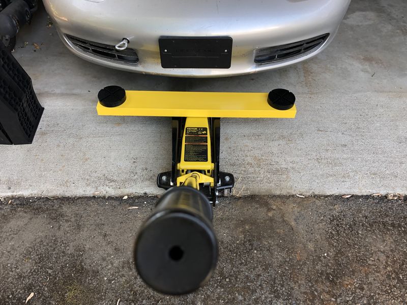

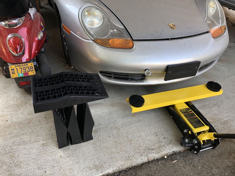

LoneWolfGal 08-01-2025 11:48 AM
I'm still alive, still getting things set up at my new place. In the meantime, since putting the car on jack stands will be my first order of business, I've been thinking about how to make the process less frustrating. The main problem with jacking up Boxsters is the lack of jacking points at the centerline in the front and back. Without them, one must use the "approved" jacking points which, instead of at the center line, are offset a foot or so to one side. As a result, the car is not side-to-side level when elevated, which causes aggravation when trying to place jack stands under the car.
Consequently, I've come up with a Grant Hargraveish solution: a 5"-wide steel channel crossways on the floor jack, with rubber pads that correspond to left and right jacking points. The channel will be upside down on the floor jack in order to keep the profile as shallow as possible and also to prevent the floor jack's pad from slipping off the channel. I ran this plan by my friend the metal fabricator, and he gave it his blessing, although he thought steel would be preferable to aluminum, because he thought aluminum would flex too much. The issue is moot, however, since I couldn't locate aluminum channel wider than 4". Rubber jack pads, including the one on my floor jack, are close to 5" in diameter.
I would be interested to hear folks' take on this scheme.
http://986forum.com/forums/uploads02...1754071951.jpg
http://986forum.com/forums/uploads02...1754073907.jpg
piper6909 08-01-2025 02:41 PM
That should work, but you don't need to do all that. The suspension and body are stiff enough that even if the lift points are off-center, the lean won't be all that much.
Here's a video:
https://www.youtube.com/watch?v=fDA-qI5HsIU

LoneWolfGal 08-02-2025 11:01 PM
Here's a video:
Thanks, Al. That was one of the first videos I watched when I first got the car. I like John Salt's videos.
I've had the car on jack stands four times now, using Salt's (and Tom Coradeschi's) method. Which works fine IF you don't need to elevate the car higher than 14" or so. As Salt observed, when raised at the recommended jacking points, front and rear, the car is higher on one side. There's no way around it.
My jack stands have a maximum height of almost 20", and I want every inch of that, to have enough room to drop the engine and transmission. A 14" jack stand height won't cut it. I can't conceive of any way I can achieve maximum height — on BOTH sides — without using something like my floor jack cross member to lift the car evenly and level, both sides at once. I've been thinking about this problem for a long time and I'm fairly certain my design will do the job.
So I'm going to proceed with fabrication (i.e., cutting the channel to length with a hacksaw) of the floor jack cross member, which I have dubbed "The Lift Master" (patent pending). ;) Any bets on whether it will work?

piper6909 08-03-2025 05:21 PM

LoneWolfGal 08-03-2025 07:35 PM
Originally Posted by piper6909 (Post 668227)
What's the lift on your jack? if it's about 22-24", then the low side should be at around the 20" you need, and the high side will be more than high enough, naturally. .
My floor jack's maximum height is 19.5 inches. My brother's jack is approximately the same. Not enough to raise both sides to 20 inches. I could buy or make tall ramps for all four wheels and stick a platform made of 2x8s or 2x10s under the jack. That's one solution I considered. Constructing the Lift Master™ ;) is even simpler: hacksaw 12 inches off a 48-inch-long steel channel, attach a couple of 5-inch rubber pads .— and it's finished! (Well... my OCD-lite will probably compel me to spray it yellow to match the floor jack, so there's that.) There's adequate clearance to get the Lift Master™ under the front or back with its channel upside down over the jack's pad. The pad will be in the trough, preventing the channel from slipping. The arms will extend out 18 inches (from the jack's centerline) on each side, pads positioned under the lift points.
C'mon, Al — you don't think it's a simple, semi-innovative solution?

LoneWolfGal 09-13-2025 02:26 PM
Thought I'd take a break from installing a new kitchen faucet to give you an advance peek at the Lift Master™. To obtain enough clearance to slide it underneath the car to the lift points I use ramps under the wheels. But then, I have to use ramps with the supposedly low-profile floor jack alone. The Lift Master™ worked perfectly in testing. The car was level side-to-side at maximum jack height. I didn't take a picture because it wasn't painted yet, but more photos to follow when I put the car on jack stands to drop the old engine (although it might be a while before I can get to it).
Lift Master™ dimensions: 5" width x 1" height x 36" length. Height added to floor jack: 3/16" (thickness of the steel channel) plus 1" (rubber pads).
http://986forum.com/forums/uploads02...1757797156.jpg
http://986forum.com/forums/uploads02...1757797178.jpg
