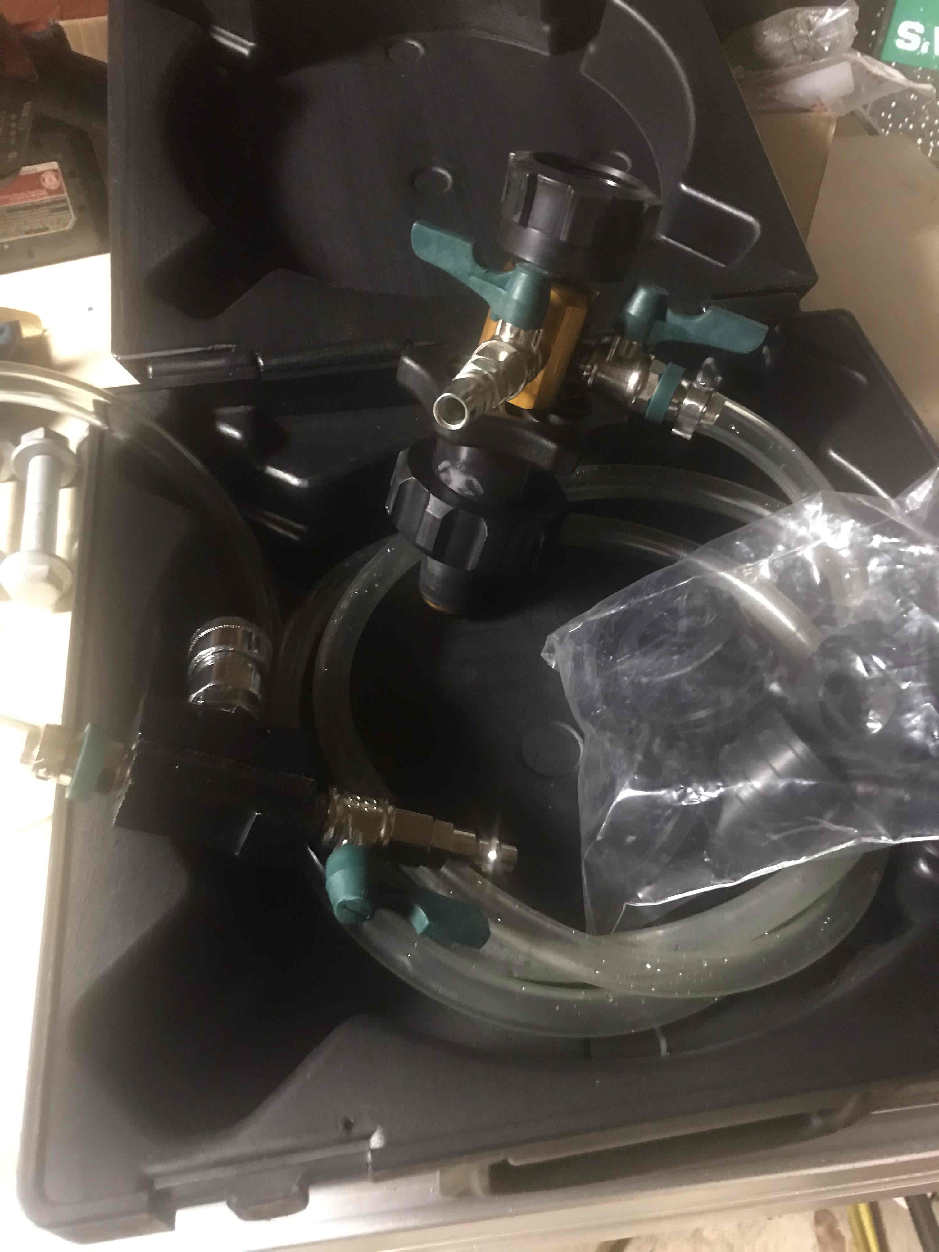

Use an airlift to vacuum and refill, they are a blessing. I recently bought the OEM brand knockoff and it works perfect, saved lots of time and made the effort easy and clean. 50 bucks.
Attachment 22392
I can't see anything. Is that a pic of Aretha Franklin Live at the Apollo?

I do have the UView 550000 Airlift for the coolant exchange. I've never used it so we'll see how that goes.
