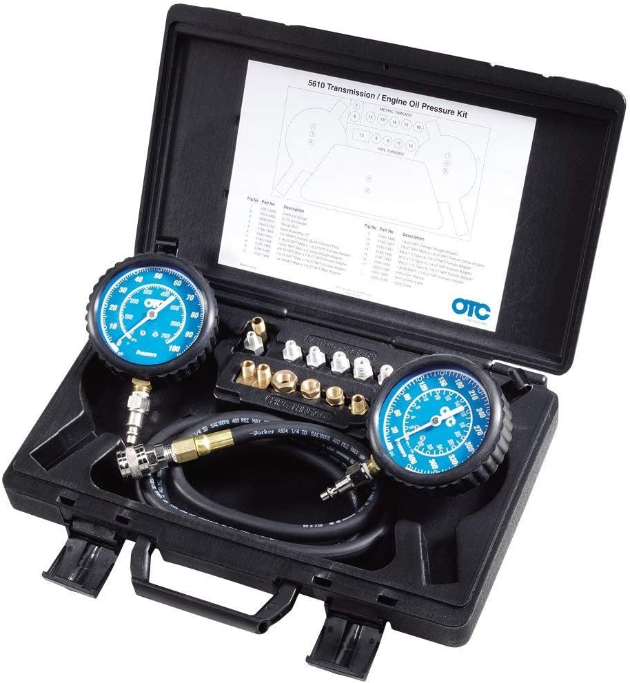

Long before I would get out the stethoscope, I would be reaching for my oil pressure test kit that uses a tested mechanical gauge to tell me what the oil pressure is doing when the noise occurs.
It could be something as simple as the $20 oil pump piston and spring update kit that Porsche released some years back to address low oil pressure at idle on these cars; or it could be something more complicated that requires further investigation before the noise becomes constant..........
Thanks. I'll pick up a test kit. Looks like they can be had for under $50. Do you recommend any particular brand? I'm sure there are plenty of vids on YouTube on how to test and where to connect.

There are a ton of kits out there, I personally like the OTC kit which I have had for years.
Thanks. As always, your counsel is appreciated.

If you are using a quality full synthetic oil, with high ZDDP and Moly additive content, nothing else is needed.
Thanks. I saw that OTC on Amazon for about $67. I'll pick it up as it looks like I can use it on my other cars as well. This is connected to the oil pressure sensor under the hood, correct?
Yes, you remove the oil pressure sending unit and connect it there. The OTC unit comes with a complete set of adaptors to fit just about anything, and plan on using the lower pressure gauge.
