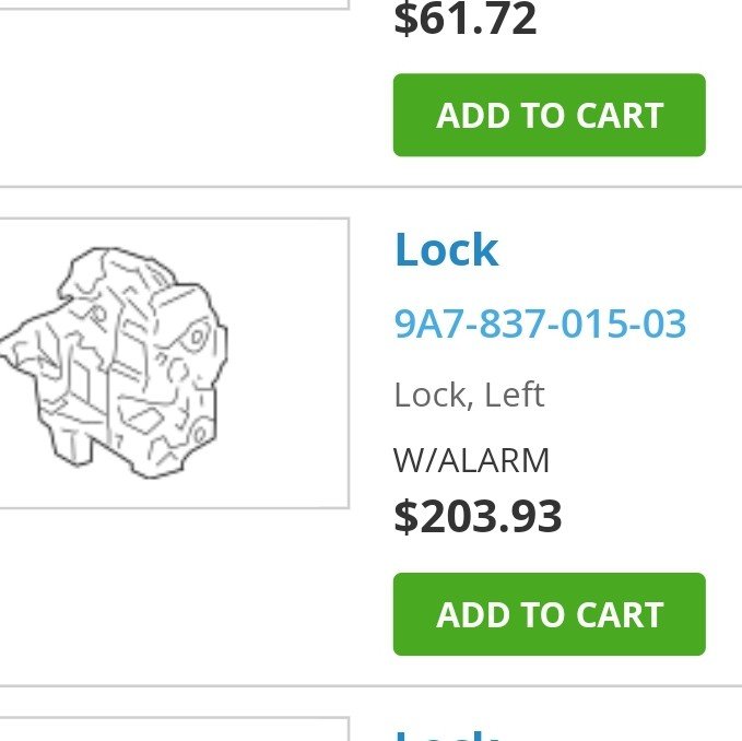

The lock mechanism will usually be the culprit. The part will run around $200.00+. Had to replace mine in my 2001. Name:  986doorlock.jpeg

With the door open, if the window does the short drop and rise when you lift and release the handle, the problem is most likely the micro-switch in the door latch. The best way to repair it is to replace the whole latch.
You can use a much less expensive latch from a similar VW/Audi, but it may need a slight modification to work.

This was very helpful. It completely makes sense that the issue is the door latch and the link to that other thread is going to make this a very easy and inexpensive fix.
