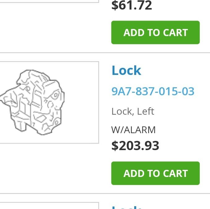

mmassey0125 03-29-2019 10:43 AM
The lock mechanism will usually be the culprit. The part will run around $200.00+. Had to replace mine in my 2001. Attachment 21852

With the door open, if the window does the short drop and rise when you lift and release the handle, the problem is most likely the micro-switch in the door latch. The best way to repair it is to replace the whole latch.
You can use a much less expensive latch from a similar VW/Audi, but it may need a slight modification to work.
