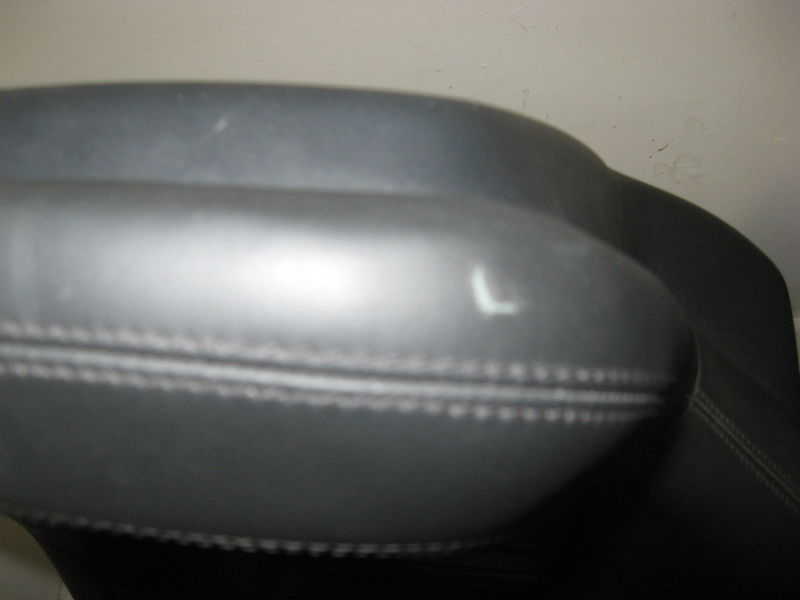

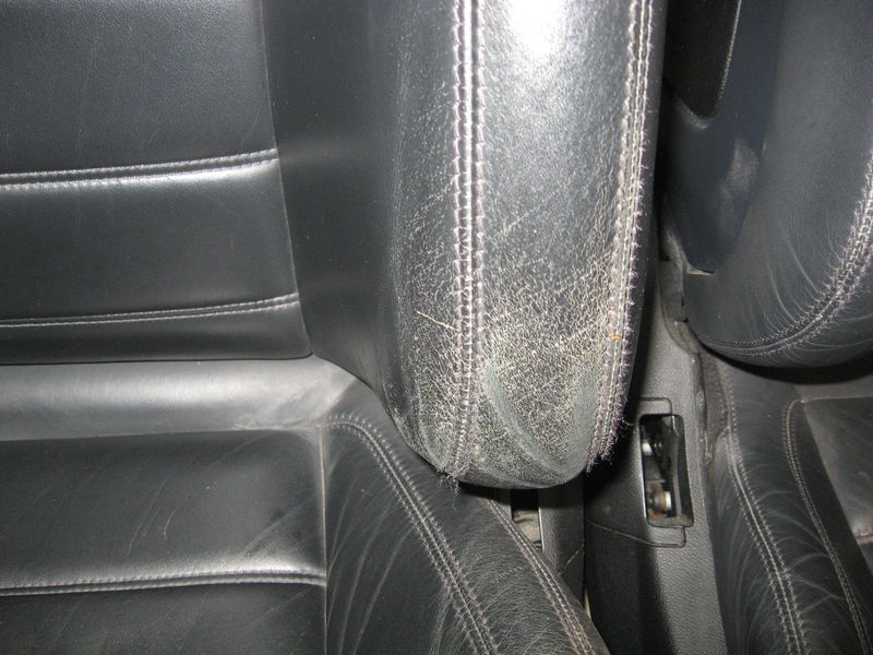

Thanks for the tip. I picked up some used seats to put in a 2005 Mercedes that I use as a daily driver and the driver's side bolster needs a repair.
There is also a small tear in the passenger seat bottom and a gouge in one of the headrests.
It looks like Magic Mender can handle the bolster repair, but do you think it can help with the gouge and tear?

You’re welcome. The toughest part for your bolster will be the seams, stitches and area between the stitches. I was lucky that I only needed to repair up to the stitch and not in the area between the stitches. Both the repair compound and the colorflex will obscure the seam, seam ditches and stitches (not reversible after the products take a set). Also, the colorflex is not suitable for redying the stitches. There are some videos on u-tube that show how you can deal with this (basically shave the fuzzies off of the stitches, tape them with a good pin stripe painting tape, apply repair compound, smooth, remove tape before the compound sets, re-smooth, retape, apply colorflex, remove tape before colorflex sets, redye the stitches with fabric dye). Practice first, then practice some more!
The gouge and the tear are actually easier than dealing with the bolster seams. Just check the how to videos online. The technique is the same for many of these products so you’re not limited to Magic Mender videos. You will not be able to match other than smooth leather textures without locating some leather impression pads which are made specifically not to bond with the repair compound. IIRC, the M-B kit used in-house has these texture pads. Sorry, I don’t have a lead for these kits. Again, practice is the key.

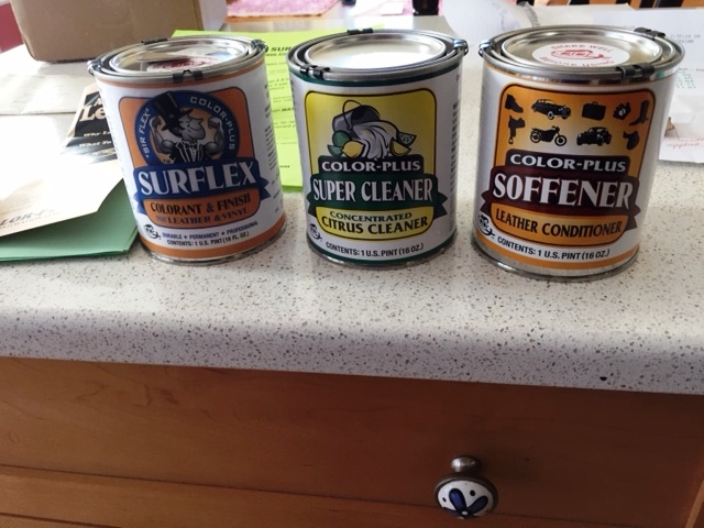

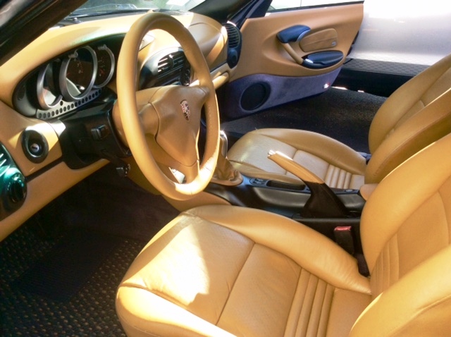

I also recently did my seats. This was the second time in 3 years. The first job (with a different product/system) originally looked great, but the repair didn’t hold up well. I had bad flaking and cracking in the bolster areas.
This time I tried the Color-Plus system. It wasn’t cheap ($172), but the results- so far - are great. Not Concours quality, but good enough for me. It was a 4-day job due to required drying times between steps. I was very impressed with their softener/conditioner - the seats feel butter soft. And the “SurFlex” color was a perfect match to my Savanna Beige (99.85% accurate to the swatch I sent them according to their analysis).
I did not take any “before” shots this time, but this one was before the first repair with the other product.
These are the after the Color-Plus treatment.
You can get more info by going to their site, or calling Joanne there.

The original kit I used included a preval sprayer. You definitely will want to practice your technique a few times before you spray the color on. It's very easy to get some "spitting" of larger droplets, and even some dripping.
FWIW, my original kit through an outfit called ColorMagic was in the same pricing ballpark as the one you may go with, and I note one similarity is there is no conditioner/softener step. IMO, this is the key step for long lasting results. You want that leather under the color to be as soft and pliable as possible.
