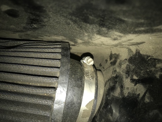

I pulled the MAF sensor yesterday after getting a P0434 code. I followed the directions from Pelican. I noticed I did not have anything covering my air filter and my filter looked like the picture below. I just wanted to see if that was normal.

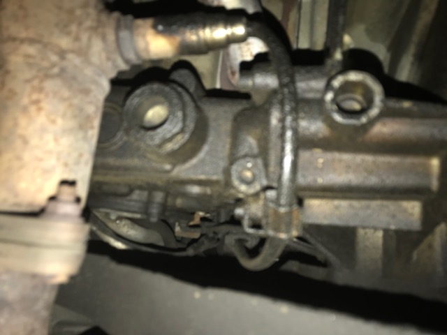

Also, I took some pics of the underside of the car. There is some oil residue. The only level is good. I checked it when I got it and it keeps showing good at startup. I have driven around 750 miles on it. I welcome anyone's thoughts about it. Thanks.

The previous owner messed up the air induction by installing that air filter. Get it back to factory specs by removing that filter and reinstalling a proper airbox, filter and inlet tube.
You have a cartridge oil filter.
Anker,
Thank you for the reply (and I saw your other one about the oil fill tube). I thought it was messed up. I will have to figure out where to get an airbox.

Any thoughts on the oil underneath?
There are multiple sources of oil leaks on a Boxster and oil has an uncanny ability to leak in one place, run down, and then drip from somewhere else entirely.
The best way to find where the oil is coming from is to clean it up and then inspect it daily until you find the exact source.
Also, be prepared for a wrestling match to get the stock air box back into the engine compartment. Its a super tight fit such that many owners who remove it, cut the stock air box into pieces to get it out in the first place. Getting it back in can be done, just be patient and work at it methodically.

Also, as far as cleaning the oil, I was thinking of using Purple Power on this to clean the oil. It is industrial grease and grime cleaner. Any concerns?
I'm not personally familiar with Purple Power, but any regular degreaser should be fine.

Wow... that filter is nasty. As it is an oiled filter, it is possible the oil residue you have under could be from it. Your car will thank you for installing the proper airbox!
