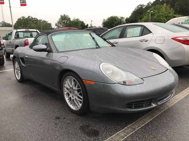

Longtime lurker, and I finally got myself a Boxster a couple of weeks ago. Seal grey/black 2001 S, with all the options I wanted (6MT, full leather, Litronics, heated seats, Sport package, etc.)

Then, after about a week, a big puddle of chocolate milkshake in the garage after a long drive. Had I bought this car at any previous point in my life (when the appeal of cheap Porsches overrode my knowledge that they're never cheap for long), this would have been a head-in-hands moment. I took it to a shop I've used in the past for other German-made follies, because I have always seen lots of 986 and 996s on the lifts there. They called that day to say that it was a cracked head. I could let them tear into it, or I could look into remanufactured engines. Knowing that fixing the head would be a bit silly if it wasn't done as part of a full rebuild, I decided that the simplest solution would be to get an engine.
I did a lot of research and found only a few places that could provide comprehensively rebuilt engines, rather than receiving and rebuilding mine (and requiring my household to work with one car for a few weeks). I settled on Vertex Automotive after having a detailed conversation with them about what I was getting, their warranty and the details of how and when we would get the thing up to SC.
So here I sit, with the engine being delivered today and installed this week. I'm still happy I bought the car, and I'm actually kind of relieved to be getting this out of the way. Am I going to end up with a $20k 2001 Boxster? Yep. Am I going to be happier with it than I would have with most any other $20k car? Yep.
