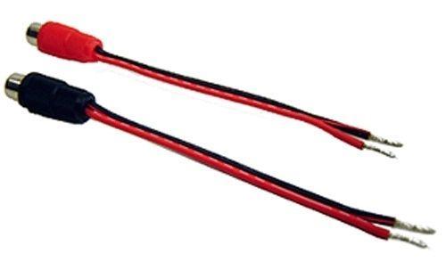

I have these RCA-to-speaker wire adapters from Ebay (but with male plugs):
So my question is how do I duplicate the CAI harness with my current Ebay harness? Do I merge red from one plug with red from the other (and black with black)? Or do I merge both wires from the same plug together? I'm guessing it's the former but I'm no expert at this...

I'm not familiar with the inputs on the Cayman sub/amp you mentioned, but if I understand correctly you're looking to use generic RCA cables to feed it. You're correct in thinking you should just run both the left and right output in parallel. (both red wires together/both black wires together and then to the amp)

Thanks. I went with that. I kept getting confused with the red/black (or white) RCA plugs. I keep thinking they're +/- instead of left/right. Shows how much I know about stereos...
