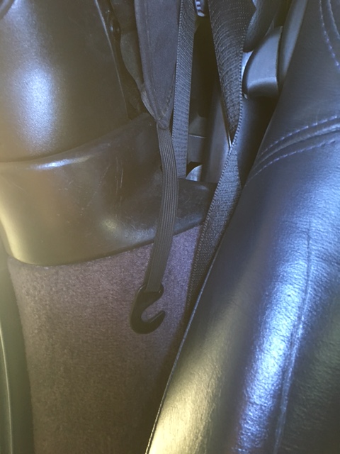

Next issue, this hook holds down the top liner just behind the passenger side seat, but I can't find where it hooks. Any help?

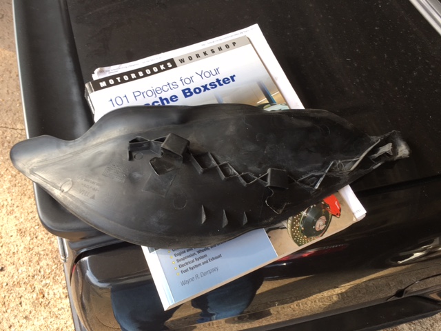

Finally, this cover piece was just laying in the well where the top goes down. Was on the right side. How does it fit. Should there also be one for the left side? If so it is missing.
Thanks for all of your help!
