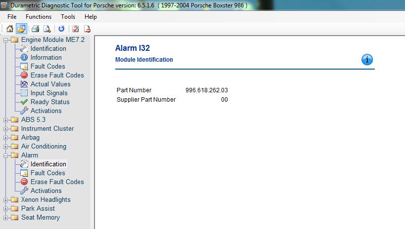

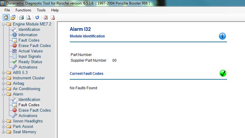

Did you get this resolved? I am having issues with my alarm and ran the durametric last night and although I don't get the error you are seeing, it appears that my durametric is not communicating.
Here is a pic of what I see with the alarm module.
Name:  Alarm Fault.JPG
I noticed that I did not have .NET 2.0 downloaded so I am now downloading it and will try again.
EDIT - The install said I already had it so now I am at a loss.
John

I got it to work finally and now have a bunch of alarm faults to figure out.
2001 Boxster S - Midnight Blue Metalic
jpc763 is offline   Reply With Quote
The alarm fault screen worked once. It now shows no errors again.
Old 03-04-2016, 12:33 PM   #14
This sounds a lot like the behavior I was experiencing. The DME showed up once, now nothing. The alarm module will read, but only intermittently.
