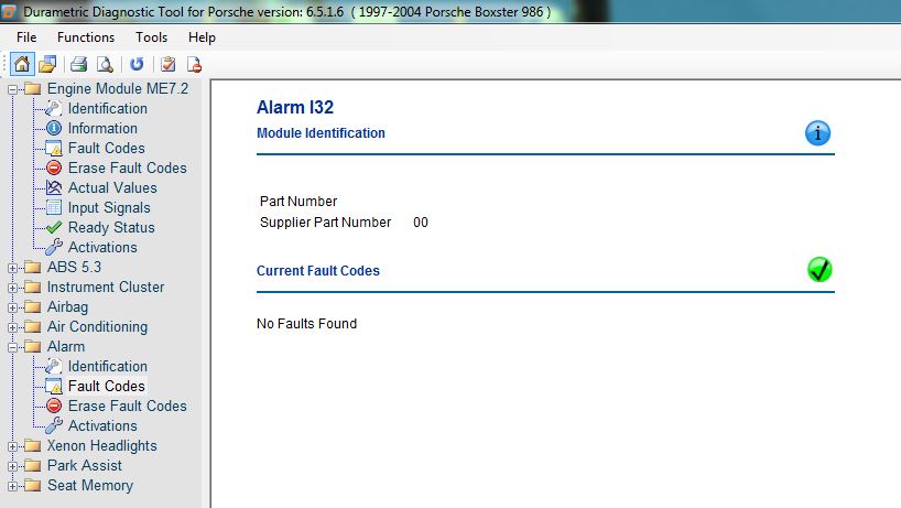

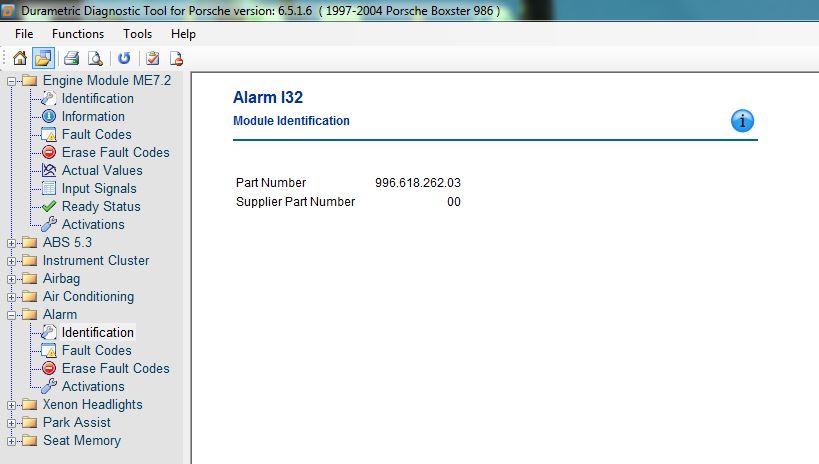

Particlewave,
Did you get this resolved? I am having issues with my alarm and ran the durametric last night and although I don't get the error you are seeing, it appears that my durametric is not communicating.
Here is a pic of what I see with the alarm module.
Attachment 20117
Attachment 20118
I noticed that I did not have .NET 2.0 downloaded so I am now downloading it and will try again.
EDIT - The install said I already had it so now I am at a loss.
John
