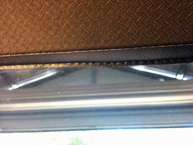

Old 03-28-2015, 12:52 PM   #11
Join Date: Jan 2013
Location: Houston
Posts: 370
Yeah the reduced visibility of the glass. Plus I work on my car myself - I don't want reduced engine area access.
Here are a couple close-ups of the stitching.
From outside
From inside (top is black, not brown from light)
