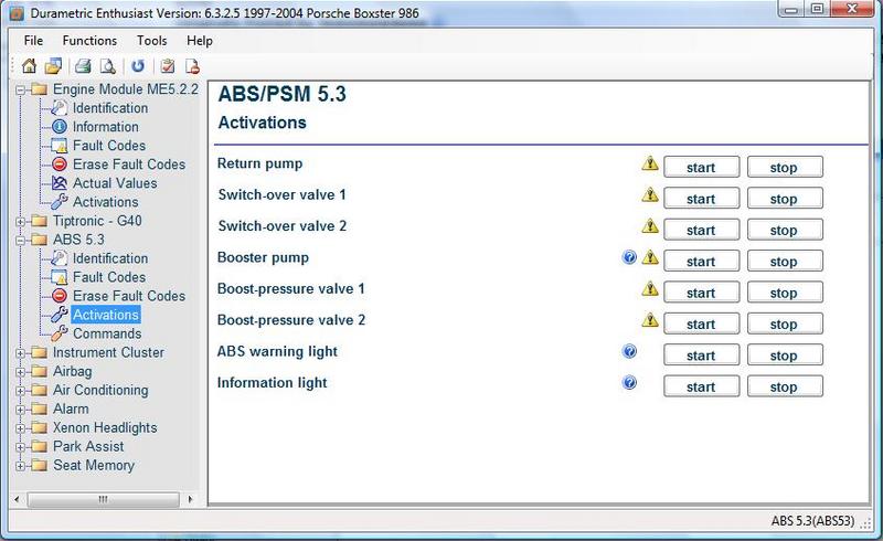

All Durametric software are capable of cycling the ABS/PSM pump during brake bleeding:

Thank you JFP! My version doesn't look anything like yours. I called Durametric tech support and they suggested I download the latest software and that should do it. There isn't any difference in feature set in the software like you suggest. So tonight when I get home I will upgrade!! You guys rock. :dance:

OK, One hurdle complete. I upgraded my software 6.3 and the ABS functions show up!! I also determined I have the 2nd generation cable, whew.. dodged a bullet there. So... my screen looks a bit different that JFP's version 6.1. I'm a bit nervous and will proceed slowly so I won't further screw up. Stay tuned guys!

So far I have been able to control the ABS light and the information light. That does turn on the ABS light on the dash, but clicking the off button didnt turn it off. So I cycled the ignition key off/on to clear the light. So I took my chances and clicked the booster pump on button and nothing happened, then clicked the off button. Nothing happened... no noise, no click, no pump motor noise. So to be safe I cycled the ign switch and shut down the app. I need to find a more detailed procedure to bleed. Nothing detailed enough in my Bentley service manual. Time for a cold beer and a shower hopefully more tomorrow.
