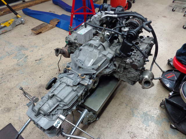

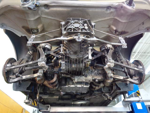

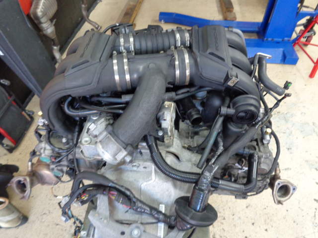

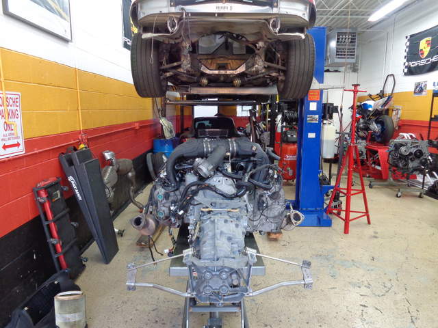

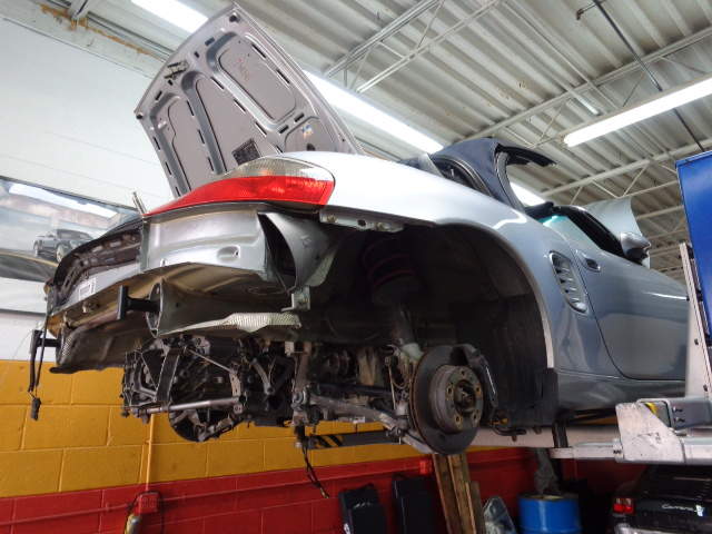

Uploaded some pics of 997 conversion process
I'm new to this but want to say that I'm not representing the shop that did it but Martin's a great mechanic and a friend, so I'm not sure what Byprodriver means by what he posted. Right now, we're working on the brake calipers and I'm doing them in 918 acid green, found a Lamborghini Mura color that pretty much exactly matches the 918 color, so I'll be able to show the whole car when done soon. Should be a cool look with the titanium rims. Here's some process pics I figured how to upload:
