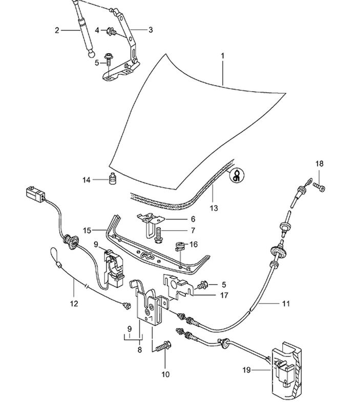

Originally Posted by rfuerst911sc View Post
You're saying if you pull the front hood release but NOT open the hood the light comes on ? I don't think so but could be wrong.
TO is probably right.
the light microswitch (9) is part of the hood latch assembly (8), and will be fully depressed only when the hood is fully closed.
