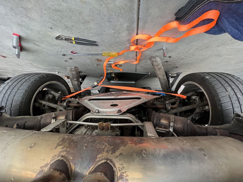

Looking for help on installing my rear pan. On the ratcheting strap technique. Are you using one strap or two? Where are you latching them on? Pic?

you are basically pulling the uprights closer together -- one strap is usually sufficient.
Don't pull in the spindles -- you are literally squeezing the frame together, just a little bit.

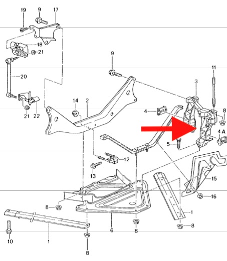

You want to place the strap above the triangle, looped around the uprights indicated by the arrow on both sides.
Grant

I am not getting them to budge. Should I loosen the bolts that are attaching the brackets?

It took a Pipe Bar Clamp!!
I had to use a 3/4 inch pipe bar clamp in order to get the mounts close enough to mount the pan!!
Thanks for the support.
