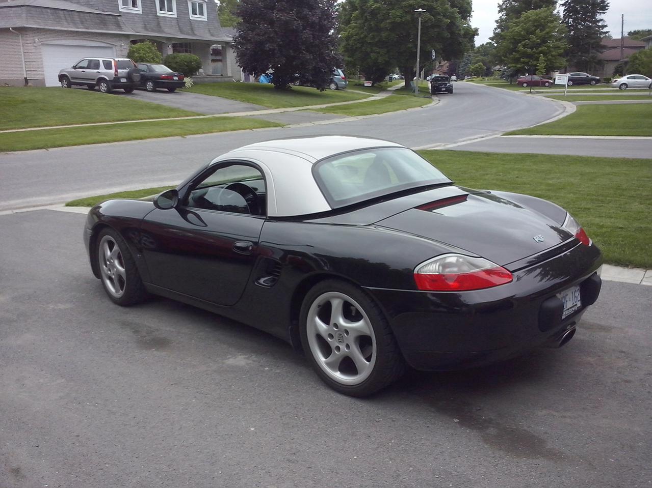

Hardtop
I just paid $1600 for a top. Mint shape but wrong color.There hard to find in Canada. All it did need was a new cover for the latch.

That top looks great as it is!
