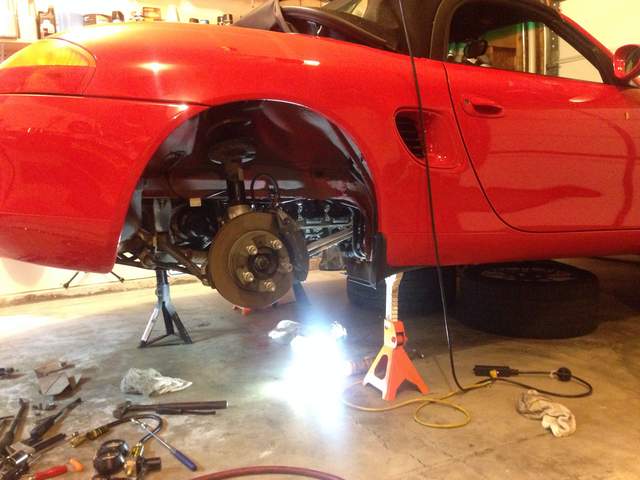

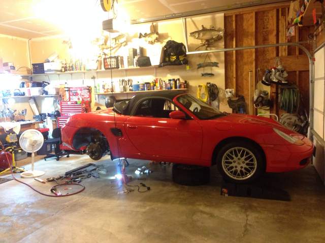

Good eye! Must have lifted the car with the floor jack and placed the ramps under the wheels, or he has another set of ramps that were under the rears and then replaced with the axle stands.
I see no way to have driven the car on to a single pair of reversed stands like that.

My son's Miata is too low in the front to get the jack under, so we lift from the side jacking point, then put ramps under the wheels just like this.

Sulking. My parts showed up, but I had to place another NDA order with pelican to get the new cam brakes and cam chain. Should be here tomorrow afternoon. So here's another pic of the garage...
