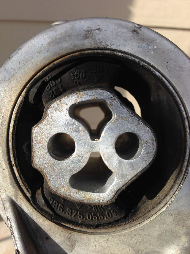

Changed the front motormount on the 04 boxster S today at 58K miles. Some cracking of the rubber at the edges, but not a lot. don't know if it was bad enough to notice any difference, it is a tiptronic. At least now I know it is good. Not a real bad job since I have a lift and good supply of tools. Would have been considerably more difficult without the lift. Took about an hour and a half, taking my time and cleaning everything up well.

I got the whole mount. I have a machine shop that thinks he can press the bushing in/out, but is not sure about getting the alignment of the mount holes just right. Decided not to chance it. I may pick up a bushing and try it with the old mount now that I have one to play with.

Generally some vibration, jerking of the gearshift lever when acceleration bumping sound when changing gears, and general loose feeling in the drive train. sometimes hardly any symptoms at all.

I changed mine a couple weeks back, did not notice really anything that pointed to the motor mount but was under the car doing some preventive work and thought I might as well do it as I had just over 65k.
Let me say one thing I can now have a nice conversation in the car, and do notice shifting seems better but as they wear over time I guess I just got use to the extra noise vibration.
After looking at it I am so glad I replaced when I did!

I've replaced mounts on three different Boxsters over the last few years. Shifting improves, idle is smoother and no harmonic vibration at ~3K rpm are the main things that get fixed.
I did swap just a bushing in the mount one time and it wasn't very hard to do. The bushing as $39. Prior to removing the old bushing, I marked it and its position in the mount. I then sat the new bushing on top of the old, alingned the holes and marked it as well.
I put my motor mount in a vice and used a hack saw to break up the old mount and pull it out. It was quite easy to do by hand. I then took my new (Frozen) bushing, alinged the holes and pressed it in using the vice. It when right in without any drama.
