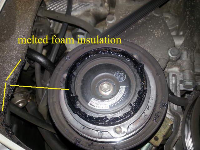

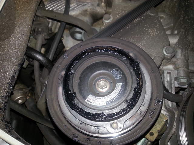

Removed the engine cover and the belt seems fine. However, I think the compressor doesn't look right.
Does the oil indicate its blown? Am I screwed?
Edit: Its not oil its some sort of sticky tar (adhesive?). It seems to uniform for that to have been accidental. Is that normal?
Since the belt is fine and tight. The compressor besides the tar stuff seems ok I ordered a scanner from amazon. Should be here by Friday.

Not sure what kind of scanner you ordered, but the way to go is to buy a new or used late model Durmetric. It will give you a lot of Porsche specific information that simple OCBD scanners don't.
BTW: if your AC compressor does need replacing, don't buy from Porsche. Find out the OEM supplier and buy the replacement form a aftermarket supplier I believe DENSO made the AC compressors for Boxsters in your model year. Pelican sells them for about $450. From Porsche, its something like $1200.

I'm no expert, but that doesn't look normal.

well, compared to a normal 986 compressor, yours look shot.
It looks like a broken seal may have spilled out some oil.
Either that, its foam backing that has melted from the hot engine.
Try running the car and turn on the AC, do you hear anything, pinging or clanking, maybe the bearings are shot? Just thinking out loud here.
It seems fine besides the sticky stuff on it. Turning on the AC I can hear the clutch and it starts to spin fine. Turning it off I hear the clutch and it stops. While running it is pretty quiet. No strange or scary noises that indicate bearings are blown or any odd noises at all. Just the complete absense of cold air. I'm wondering now If its just as simple as a recharge needed?
Doesn't explain the two stalls I had Monday tho.
Edit: doesn't explain what the black sticky stuff is as well :P

Everything points to a failed compressor...AKA the Black Death. Check the pressure on the service port. Probably empty.
Unfortunately, you'll probably have to get the whole system flushed as its possibly full of metal shavings.

I think the black sticky stuff is the melted foam insulation around the opening edges. Check the back of the engine belt cover, do you see the foam melt as it would be on that as well.
The foam when hot and melted will have sticky black residue. I don't think the two issues are related. One think you can try is to get a R134a recharger, find the correct port to refill and see if that is any better before spending hundreds on a new compressor.
It could be a condensor or dryer unit as well. Go with cheaper items first I always say. Still doesn't explain your stalls, that could be a third problem that is related to tune-up items. when was it last tuned-up i.e. spark plugs, oil change, coolant flush, air filter?

Yea Soucorp, I really am not sure that black stuff is "black death" Seems too much like adhesive or melted material. Gonna run a diagnostic on Friday (hopefully) might try the refrigerant sooner or not.
It could all be bad luck and random occurrence I guess with the stalls. But better to check things out.
