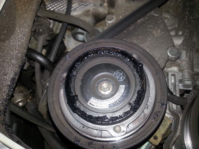

Removed the engine cover and the belt seems fine. However, I think the compressor doesn't look right.
http://986forum.com/forums/uploads01...1371581467.jpg
Does the oil indicate its blown? Am I screwed?
Edit: Its not oil its some sort of sticky tar (adhesive?). It seems to uniform for that to have been accidental. Is that normal?
Since the belt is fine and tight. The compressor besides the tar stuff seems ok I ordered a scanner from amazon. Should be here by Friday.

I'm no expert, but that doesn't look normal.
soucorp 06-18-2013 02:32 PM
http://986forum.com/forums/uploads01...1371590929.jpg
well, compared to a normal 986 compressor, yours look shot.
It looks like a broken seal may have spilled out some oil.
Either that, its foam backing that has melted from the hot engine.
Try running the car and turn on the AC, do you hear anything, pinging or clanking, maybe the bearings are shot? Just thinking out loud here.

It seems fine besides the sticky stuff on it. Turning on the AC I can hear the clutch and it starts to spin fine. Turning it off I hear the clutch and it stops. While running it is pretty quiet. No strange or scary noises that indicate bearings are blown or any odd noises at all. Just the complete absense of cold air. I'm wondering now If its just as simple as a recharge needed?

Edit: doesn't explain what the black sticky stuff is as well :P
particlewave 06-18-2013 03:19 PM
Everything points to a failed compressor...AKA the Black Death. Check the pressure on the service port. Probably empty.

I think the black sticky stuff is the melted foam insulation around the opening edges. Check the back of the engine belt cover, do you see the foam melt as it would be on that as well.
The foam when hot and melted will have sticky black residue. I don't think the two issues are related. One think you can try is to get a R134a recharger, find the correct port to refill and see if that is any better before spending hundreds on a new compressor.

Yea Soucorp, I really am not sure that black stuff is "black death" Seems too much like adhesive or melted material. Gonna run a diagnostic on Friday (hopefully) might try the refrigerant sooner or not.
