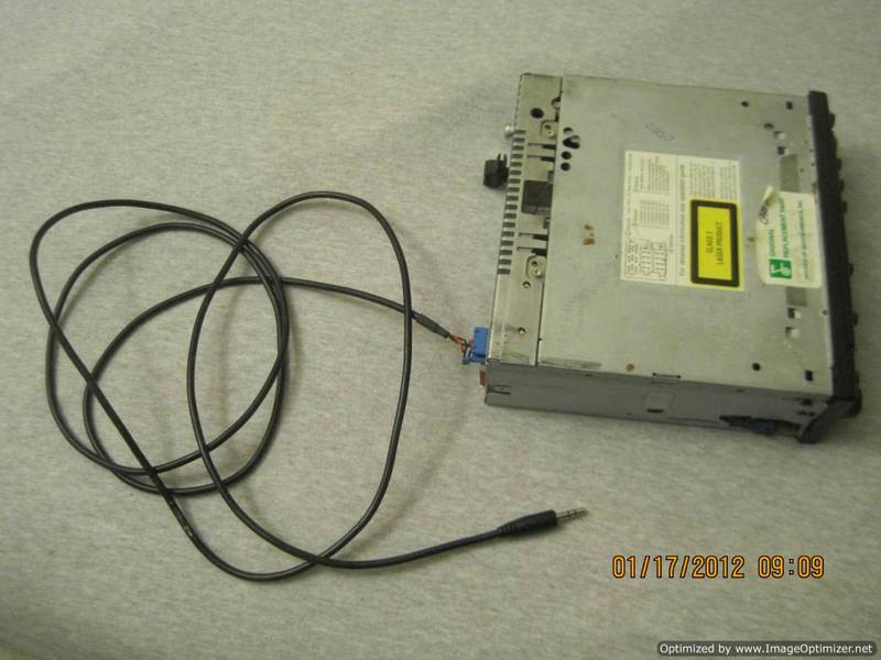

Yes there is. See the pics of my CDR 220 with the AUX cable. I just sold my head unit recently and kept the pics. You should be able to google it to find the part.

Terry, I was too quick to reply to the forum. My pics were for a generic AUX device and not iphone. (I should have read the iphone part).
Sorry for confusing the thread.

I've never pulled the radio out. Is it attached via a cable or does it just attach to
a plug ? Looking at GreenHeckler's photo tells me it just connects to a port/plug ?
