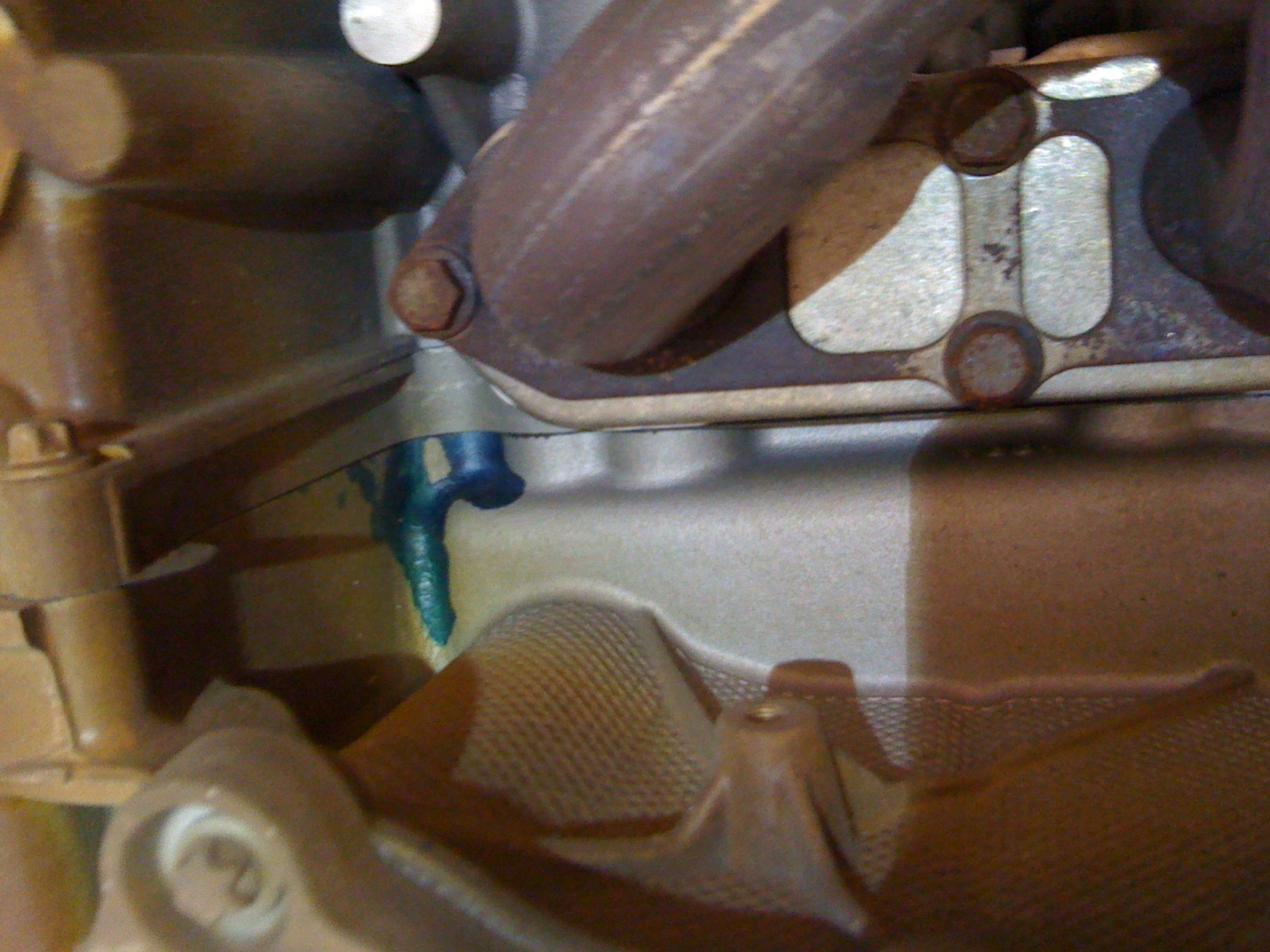

I also noticed some oily dirt on the rear left strut. And there was a blue stain on the left bank at the front and back of the head gasket. I'm trying to post pics of this stuff. The mechanic had no idea what it was.

buy at the right price and change the clutch, RMS and IMS and you have solved several potential problems. I'd be concerned with that blue stuff and not knowing what occasioned it. Sounds as if some work was done and who knows by who or how well.
