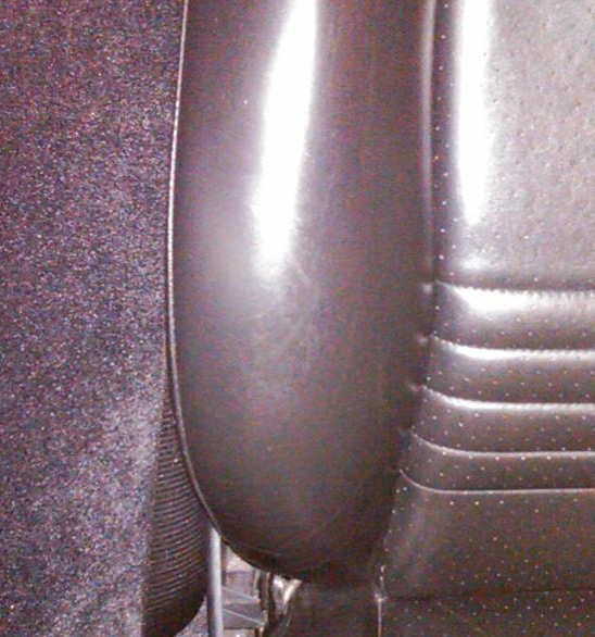

I reconditioned my seats and am really pleased, saves a ton of money. Hard to get good before and after pics in the basement with a flash but I think from the pictures you can see they look awesome.
I did all 4 steps, rejuvenate, clean, prep, dye. If I hadn't had scuff marks I would have only done the first 2 steps. For those out there with nice seats and very few scuffs I would highly recommend the first two steps, you will be amazed at the results.
Since I had to wet sand to dye, the finish comes out very smooth and satin in look. I watered down the dye a bunch so it wouldn't look like paint and wouldn't be too shiny (this was 'my' method, many thin coats). I did the passenger seat first and then the drivers, the drivers came out better because I had learned a lot from the first seat.
First pic is a BEFORE of the passenger, the next two are AFTER on the drivers seat, drivers seat had more wear but less deep scuffs. I filled no wrinkles, I like the slightly wrinkled look, has similar character to my 50 year old face
I used Leatherique (no affiliation), they were recommended by a friend at work. George is real nice and helpful.

Clickman, seat is already back in car, but I took a pic tonight with a flash. The flash is good for showing imperfections. You can see it is much better and since it looks better in natural light I didn't add more dye, though after I see in the sun I may do some touch up.
