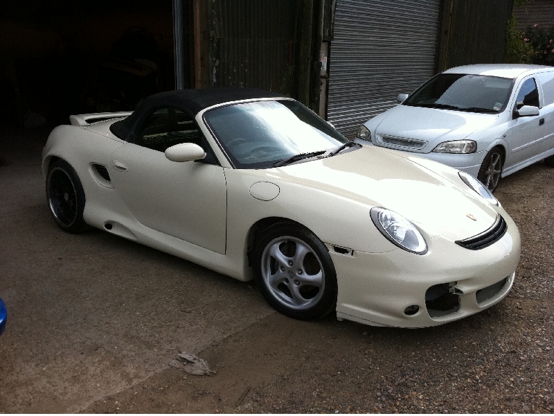

after having a few months driving about in my boxster,,, first time i have owned one,,, my son couldnt insure it,, we decided to do a 997 front end conversion,, we managed to get hold of 997 turbo front bumper,splitter, and head lights, we was gona work with every thing else,,lots of work,, this wasnt straight forward were still half way throught the conversion as nothing fits so having bits moulded,, anyway after reading the forums for help iv come across a lot of talk about engine conversions iv read lot of ideas and opions ,, and ive decided that iam going to do a 4,2 v8 twin turbo audi conversion,,,, what iam looking for is there anyone who has done this,, pictures or info,,, lots of people have talked about it but havent heard of it done,,i no theres a ls v8 being done,,and a few others but not a audi, all help would be gratefull, ,

as before,, theres a lot of talk and info on the net about,, sizes ,measurements etc,,, but apart from the talk and wondering dont seem to be anyone whos done it yet,,,,,iam not a Mechanic but have done a few projects over time,, ive already clapped eyes on a 1997 Audi A8 4.2 V8 Quattro, complete car,, i also have been offered a bi-turbo set up for this car,,, so looks like iam gona be the first,,, i wont be doing the hard work lol,,, i have a mate who speacializes in audi and bmws,,, so hopefully might make it a bit easier,, conversion is gona take place out of the car,,, once tranny ,and lump up and running then will be slowly,, added to the shell,,, i will post pics as things go with all problems,
just a update on front end conversion,, 997 turbo front bumper is 2inches wider than boxster wings,, 997 lights will not fit boxster wings without making new seatings,, boxster bonnett needs to be rouned in corners to fit 997 bumper,, all front end nearly done,, wings widened,, bonnett rounded,,, seatings for light be fitted,,,
next widening the rear by 4inches a side
